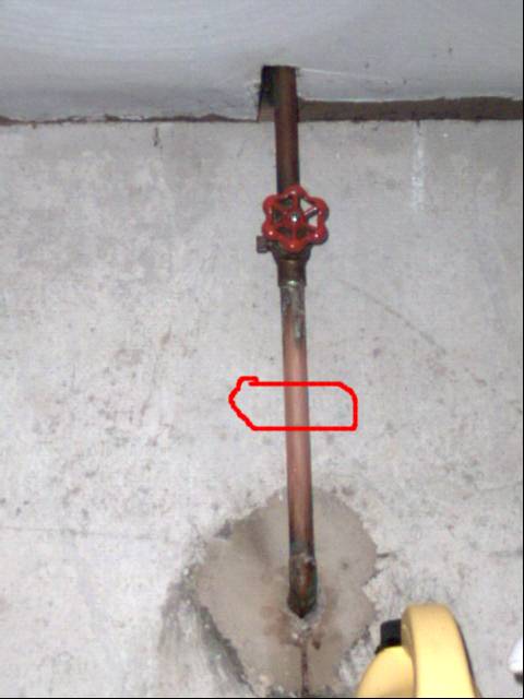

    I need to install a tee at the circle. If I have to cut the lenght of the tee out what will be left to soldier. I can't cut the pipe and move it up or down to install the tee.

    You need to use a slip coupling and install a short nipple on one side of the T. You cut the pipe slide the t on 1 side and measure the other where the nipple stops and cut the pipe there. Slide the slip coupling all the way on the copper pipe, install the T, slide the coupling 1/2 way up the nipple, aim the T where you want it, and solder it up or continue running your copper and then solder.
    Be sure to clean and flux all pipe and fittings to be soldered.
    19,217
    A slip coupling is basically a straight coupler without the normal stop in the middle that centers the two pieces of pipe. This allows it to slide entirely over the pipe. It's not a bad idea to mark or measure the pipe so that when you slide it back over the cut portion, you've got about 1/2 of it over each cut portion.
    12,431
    There is no rule that says you have to run this straight.
    If you buy three 90 els and a tee, you can offset the pipe and add the tee without a slip coupling.

    I gotta believe that if you just cut out 3/4" that you will be able to get enough movement to get the tee where you want it. I don't see any problem.

    When I see a situation like that I always wonder if it will be possible to get all the water out of the lower pipe and shut it off completely. If there is a trickle of water or the water can't be removed, it will be impossible to solder. If there is NO water from the lower pipe, and the valve above doesn't leak, then the water can be displaced from the lower one and the joint can be soldered.

    Just turn the water off and take the pressure off somewhere at a fixture that's low in tour house, like the basement laundry tub.
    Shine that pipe with sand cloth.
    Cut 3/4" out of the pipe at the point that your putting the tee. If you need to dry out the pipe, use the torch. You can boil the water out of that lower part.
    Solder the tee and a short piece of pipe, then solder on a valve.
    I think you will find that its not difficult.......

    Not a very fancy solution for water in a short length of pipe like this, but with a short length of tubing you can suck the water out.
    this is inside of my basement. The part going into the wall is going to the outside faucet.
    Yakima WA
    6,841
    Then this is really simple. The stopless coupler is a simple answer. What is the point of using some "just as good as" product when sweating with a torch is so simple, so sure, and so time proven?
