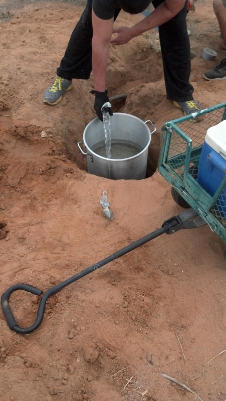

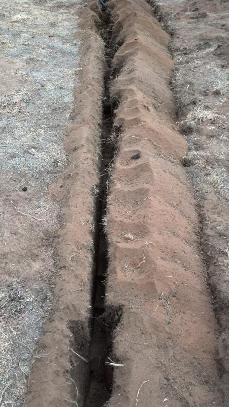

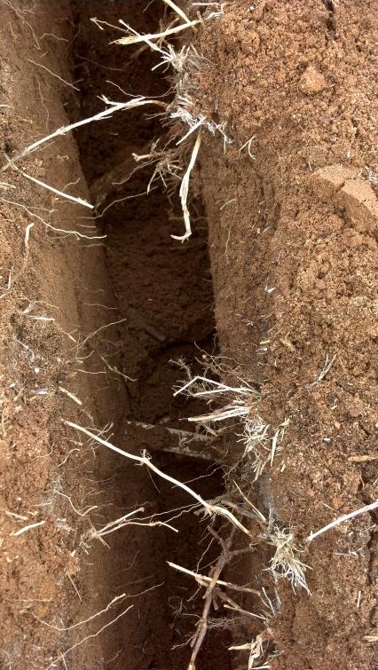

    Yes, we know it is a favor. The manager, Scott, was a life-saver years ago when someone hit the main and no one had the pieces to fix it! I will bake them cookies for life! I swear I will never, ever, ever complain about the prices plumbers charge ( for not making your yard look like a mine field!. First picture is of Nephew fill tamale pans with water from the broken main to use for flushing toilets. The other two are of the trench they are digging. I forgot to get a picture of some contraption my nieces made that made me laugh. They thought that it would be easier to take a hunk of cement and a piece of horse corral and drag it through the sand with a truck to dig a trench. Cute idea in theory, I suppose. I have go to work again, and can't even imagine what will go on while I am gone! One of my nieces is a bit of a celebrity and put a facebook message out for help. I hear there are minions on the way. Name:  2013-01-23_09-22-36_789.jpg
