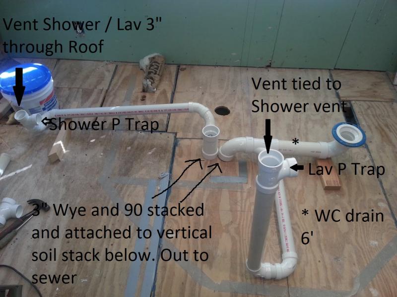

    After review of IPC and some additional help, I think this lay out would work and meet code. The three inch and two inch join on vertical stack w/ wye. Would this work? Thanks
    https://plus.google.com/photos/10538...29767507480577

    The water closet vent works, if that is the drain and vent for the lavatory. I am not clear what you are trying to do on the left side. We are only allowed to wet vent through the lavatory. You should use only long-turn 90's on the horizontal.
    The folks here can't easily tell what pictures are old and which are new. I suggest you cut it down to 2-3 photos and/or label them and you might get more comments.

    Name:  Main Plumb.jpg
    Here is a better pic.
    https://lh5.googleusercontent.com/-O...Main+Plumb.jpg
    Shower p trap noted
    Shower / Lav vent through roof noted
    Lav P trap noted
    3" Wye and 90 from WC stack fit and joined to vertical soil stack in chase below floor
    WC drain will be 6' (IPC allows up to 10. UPC is 6 i believe)
    Lav and shower vents will be connected w/ 2in and dry vents through roof.
    Lav drain will act as wet vent for the WC drain. (This pic blocks the long sweep 3x2x3 wye connecting the drain to the wc drain)
    Thanks again for your help.

    That picture is much better.
    I'm wondering if you can fit it in the joist space with everything pitched properly, and if it can be installed that way without hacking any joists?

    Yes, the drops are well w/in 1/8 ft for the WC but the shower Ptrap has some height issues. I'll have to make a larger hole for the shower T to allow the hub up into the sub-floor. The only concern I have is how to keep the WC flange plumb and square to the floor. Will I have enough play in the glue up to compensate for the <1" drop for the flange into the bend. I think I can split the difference between the where the stub enters the bend and also enters the flange.
    This all sits over a downstairs Jack and Jill closet space So the bored floor joists are actually sitting directly atop the closet/wall below. This avoids any cutting into the span section of the joist. The previous owner cut and hacked this section so the cross cut holes are there.
    Do you think the venting and configuration of this layout will suffice? Thanks for your assistance. I truly appreciate it.

    A "right hand side inlet tee" would give the toilet connection AND the shower connection at the same level. Whether your desigh is the "best one", and ALL of them seem to be the same, depends on construction details we do not know about. BUT, the "U turn" one is a "dumb idea".

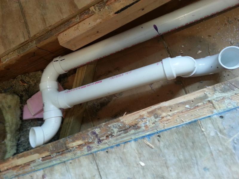

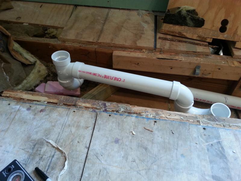

    Have you ever used a San T on its back and street 45 rolled to at least 45 (more like 80') as a dryvent for a shower? My problem is when the SanT is on the vertical, my shower arm is above the floor. If I turn it on its side, roll it up 45,(more like 80') I can vent up and into the wall, no problem. Here are two pics. A is my problem B is what I want to do if possible. Thank you for your time. I am almost finished.
    A: Name:  20130206_131059[1].jpg

    B: Name:  20130206_131214[1].jpg

    I guess I could use a TY and bring the vent up past that?
