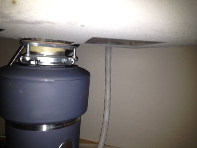

    Could you post a photo of the drain situation under your sink, how the DW is connected/ Do you run the DW at least every 2nd or 3rd day??

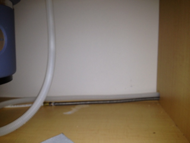

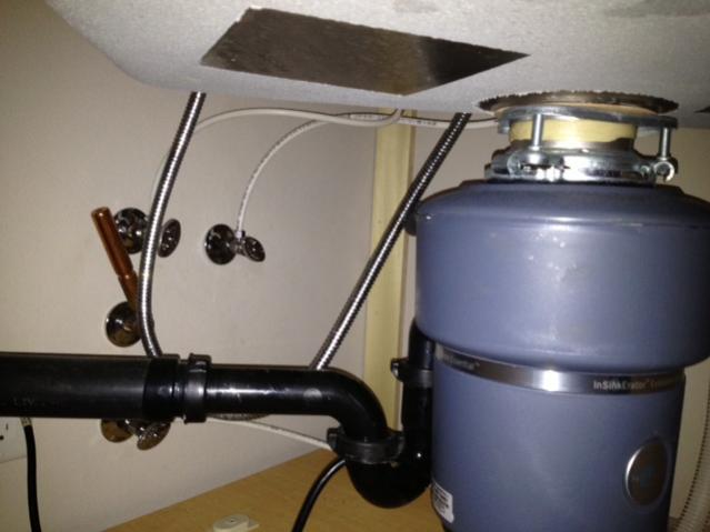

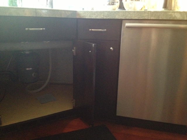

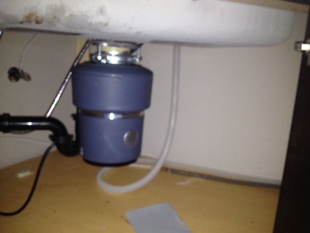

    I have contacted Bosch, but have not heard back as of yet. Since this was an issue with our first dishwasher as well, I thought I expand my search for help. Thank you for sharing appliance Junk with me. I will post there too.
    I run the dishwasher everyday, sometimes twice. I am an avid cook. Name:  photo 1.jpg

    Can't see what I would want to see in your pictures, but it certainly looks like they did a lousy job installing the outlet hose from the DW. You want the line to run up to the top of the cabinet or an air gap, if required in your locale (and a good idea everywhere), then always running downhill, make the connection to your drain. Prior to making the connection to the drain, cut off any excess hose. In this case, that connection is probably the disposer's tailpiece. The fact you have it running down and laying on the bottom of the cabinet means that there will be a bunch of stagnant water in the hose, and if there's any food particles, it would just sit there and grow crud.

    Couple of questions: (1) Is that corrugated white hose going up to an air gap on the sink? I can't see where it then connects to the drain or to the disposal. Did they put a new air gap in when installing the dishwasher, or just use the old one?

    (4) Again maybe a dumb question, but it looks like you have a separate wall-connection for the hot water to the dishwasher. Have you ever put a hose on there, run that water into a bucket, and smelled it? It should all be coming from the same place, but I can't see how things are hooked up behind the wall...

    Just notices what appears to be a water-hammer device where the hot water connects. Those can be odor sources.
    Good spot, Jimbo!!
    SMELLY, do you see what Jimbo is talking about? You have three protrusions from the wall on the hot-side plumbing. Your sink is hooked to the top one, the dishwasher to the bottom. In between is a copper protrusion that's bent upwards. What that is is a piece of pipe with a piston in it that mitigates the shock wave ("water hammer") that can occur in the line when the quick-closing valve on your dishwasher's water inlet shuts off. It keeps pipes from banging. The vast majority of people don't have this device, and do just fine without it. It appears to be plumbed in between the hot to your sink and the hot to your dishwasher.
    If Jimbo is correct (and I assume he is because he is a highly-respected veteran plumber) that these sometimes cause smelliness, I would therefore do what I suggested above, which is to run some water from the hot water tap for the dishwasher through a hose and into a bucket, and give it a whiff. If it's musty-smelling, you probably have your culprit. You could have your plumber just remove the arrestor and you'll have solved your problem.
