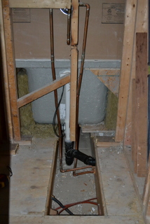

    I'm putting in a laundry closet on may main floor. It shares a wall with a bathtub in another room, which drains horizontally through several floor joists before joining the vent stack at a wall 5' away. (See picture.)
    As you can see, it's a tight squeeze. I'd like to add drainage for the washer and laundry sink to the same horizontal pipe currently used by the bathtub. As I see it, there are two options.

    You need a vent for EACH device or you will siphon the other traps when you run the WM. You may also find that code would require you to make the drain line larger if you add other things to it. There's a limit, based on the drain line diameter, how far the trap can be from the vent. And, there are some pretty specific rules about where the vent and the rest of the drains can be installed. BOttom line, I don't think you'd find any inspector that would pass what you're interested in doing with your proposed plan, and for good reason. You need a separate trap on the WM drain, and it must also be vented. That doesn't mean you must run a new vent all the way through the roof, but there are some specific rules on how to join into existing ones, too.

    The line for the tub is a trap arm and cannot be tied into. A laundry drain requires a 2" line and it must be vented.

    I'm not sure how to interpret what's been suggested. Are you saying there's no good way to do what I want to do? I don't see what's wrong with Option 1 (if you ignore concerns about the pipe diameter -- see next paragraph.)
    I'm stuck with a 1.5" pipe -- that's what's already in the joist. The washing machine is currently located in my basement. It's currently drained with only a 1.5" pipe and the vent opens into the room, not to a stack vent. Also, it currently shares a trap with the nearby laundry sink. That's probably not legal, but it was like that when I bought the house six years ago and it's served me well.

    I would be surprised if the plumbing code in Canada was all so much different than ours. Here, a trap for a washer cannot be below the floor. If it is a new install it has to be 2". A sink drain which is not a bathroom lavatory also has to be 2". Every fixture must have it's own trap, and each trap must be vented to prevent siphoning.
    It would not be in the best interest of anyone to suggest doing something which is not acceptable under the plumbing code, which is a minimum standard.
    25,624
    1. You could not legally, or sensibly, connect them all to the same trap.
    2. If you connect a washer to the 1 1/2" tub drain, your next question to this forum will be how to keep the washing machine water from filling the tub when it drains.
    3. The "horizontal" section of the tub drain has NOTHING to do with making it an "S" trap.
    4. re. Option #2. You do NOT connect multiple fixtures, other than a two compartment kitchen sink, to a single trap.
    5. HOW you connect multiple traps to the same line determines where, and how many, vents are required.
    6. THis is probably NOT a good DIY project.
