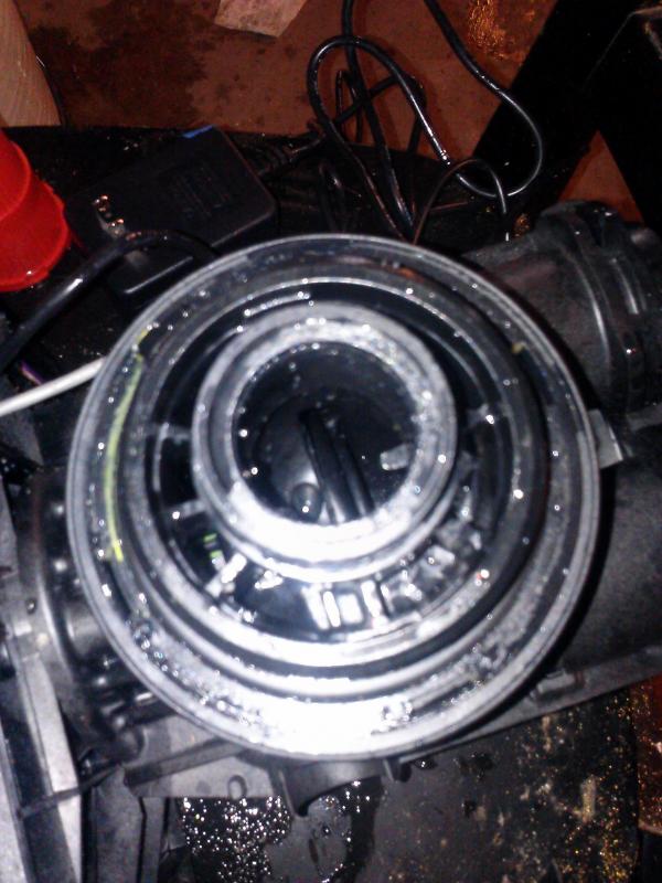

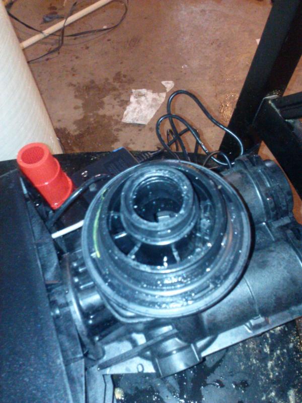

    - I took the fleck head off the resin tank and examine what I believe is the distributor to see if it's broken. Seems fine (see pictures).
    I emailed the discountwatersofteners.com and was told that I should give it a chance to sit overnight and make brine properly and that if it's drawing brine it should work. I'm not sure about that, I thought I should have good brine in a few hours.
    Anyways I would appreciate any help or advice I can get. I would even take a referral to someone around north columbus oh who I can call to come over and take a look at this for me. Either way I'll be sure to post my progress with this issue here for the sake of contribution.
    [Pictures bellow are of the control valve off the resin tank observing the what I believe is the distributor cap on and off the unit as well as the red sieve that fits over it.]

    In the last picture, that looks like the 32mm x 1.05" adapter. if it is, it is not installed correctly. Part # 61419 should not be removable once it is installed. You need to remove the 32mm oring and o-ring retainer from the valve, pt#'s 19054 and 40538 from the valve, and snap the adapter into place.
    Warning, do not attempt to remove the adapter 61419 once it is installed correctly.

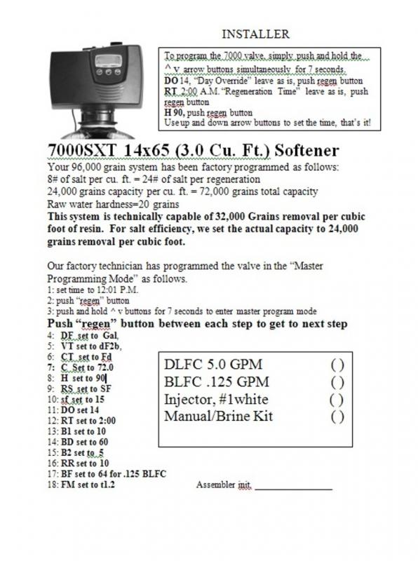

    Here is a simple programming guide for your system. If it is a properly sized 3 cu. ft. system, then it should be in a 14x65 tank. This would use a 5 GPM DLFC button. White #1 injector. the .125 BLFC is fine, but the brine refill cycle will be quite long. If you program it exactly as shown in this guide, you should be just fine. I have already adjusted this for your assumed TDS.

    Note that Dittohead's instructions have a DLFC of 5 gpm while the poster says the unit has a DLFC of 3 gpm.
    Additionally, I would expect that the unit has fine mesh resin is probably being used because there is iron in addition to hardness and if there is iron a compensated hardness should be used when setting up the unit. Compensated hardness equals hardness in grains + 5 x iron in ppm.
    So if your hardness is 80 and the iron is 2 ppm the compensated hardness is 90 and H would be set to 90. (I note that Dittohead has apparently further adjusted the hardness setting for the TDS by adding an additional 10.)

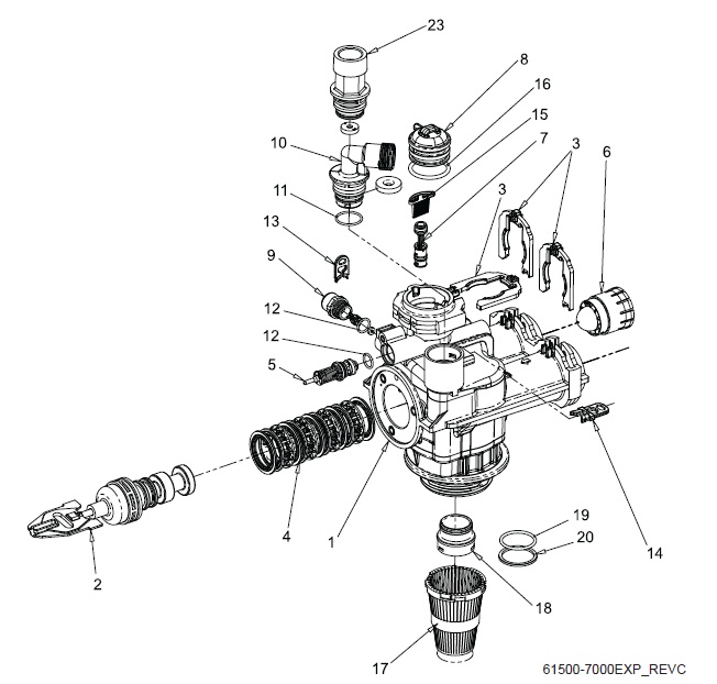

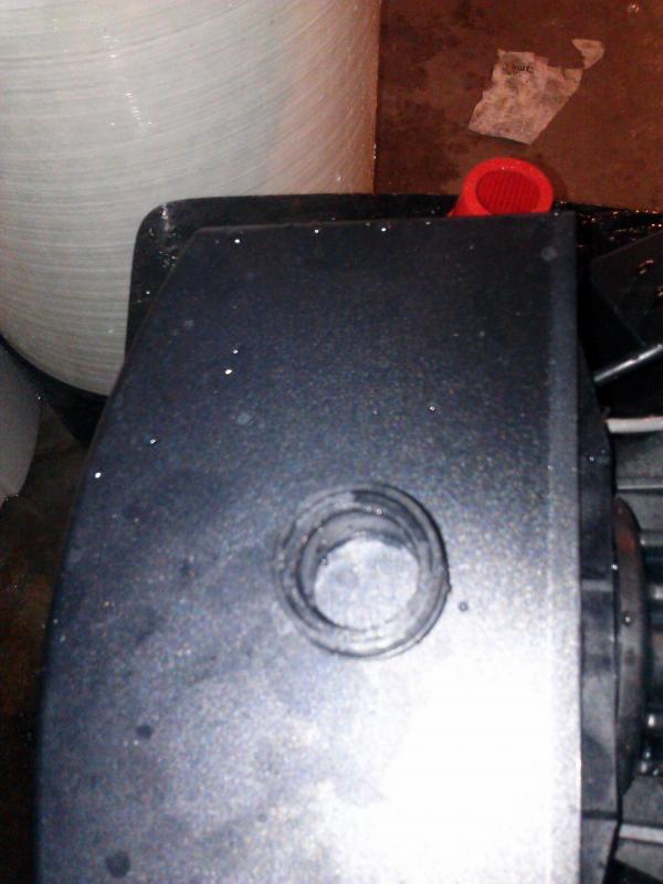

    Dittohead, you touched on a interesting point regarding the 32mm x 1.05" adapter. Again I'm attaching a picture for my own benefit and for others searching the web. It's labeled as #18 in the diagram and was simply pushed up into the valve when I received it. It was not easy to remove but I was able to slowly wiggle it out using the 3 small notches on the sides as grip. There is an O ring inside of the adapter that I have not previously messed with, would that be pictured as #19 in the picture? Once I find and remove the O ring and O ring retainer what do I do with them? Just a bit confused about that part of your instructions.
    I'll also do the "taste test" this evening. Looking forward to a mouthful of salty water.
    18.............................1.................. ............61419................................. . Kit, 1.05" Distributor, Adapter
    19.............................1.................. ............19054................................. . O-ring, -124
    20.............................1.................. ............40538................................. . Retainer, 32 mm, O-ring Dist, 7000

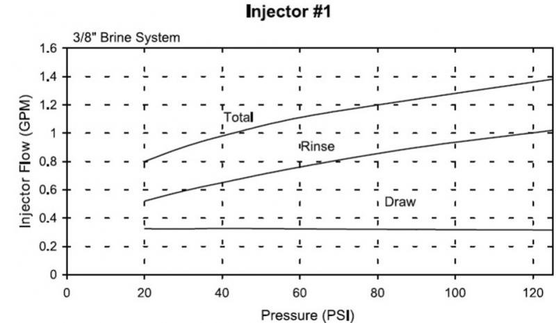

    Actually, the BLFC does nothing for brine draw, it is the injector. The BLFC is a directional flow control, it is unrestricted in draw, restricted in fill.
    A #1 injector draws about .35 GPM, assuming 8 gallons of water in the brine tank, the water should be removed from the brine tank in approximately 22 minutes, allowing a .8 gpm slow rinse for the remaining 38 minutes. The 60 minutes is pushing the recommendations, maybe an additional 10 minutes would not be a bad idea, but 60 will probably work just fine. Name:  injector1.jpg
    This is assuming he has the correct injector. A #1 injector on the 7000 is white.

    The retainer and o-ring (19, 20) are discarded. I am surprised that there are companies out there that still dont know to remove the retainer and o-ring. The adapter will have its own o-ring on it. If this is not locked into place, it will work for a couple of years, but eventually, the adapter will fall down over the manifold and hard water will bypass across this area. The adapter is installed by pushing it with force into the valve. You may here a slight "snap" as it seats and locks into place. The salt taste test at the drain comes in handy when this piece is installed incorrectly and falls down an inch over the course of a few years.
