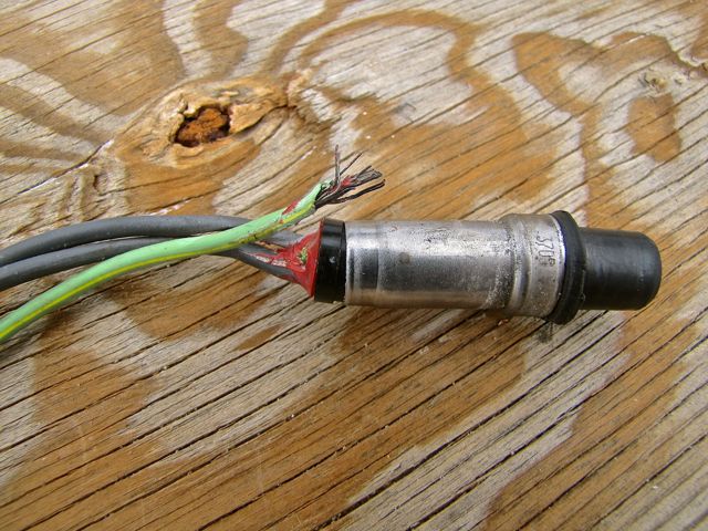

The well pump and well pump motor, looked good.
Do you know where I can find this electrical connector that plugs into the Gould Bruiser motor?

If that is a Franklin motor you will need a Franklin wire plug in. If it is a CentraPro, you will need to get one from Goulds. I am not sure they will interchange.

Thanks, found the lead plug-in, on their Manual, will call them tomorrow.
Lead plug-in has three wires going in, and has two metal leads on the other end.
All three wires were broken going in to the plug-in.
