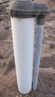

    I like a trench depth of 4-4 1/2' deep, but I have seen water lines at 2' that didn't freeze.
    You can certainly put more fill around the well, but I would rather see a new pitless installed and the line buried deeper.
  2. #32
    DIY Junior Member DYIWeller's Avatar
    Jan 2013
    Santa Fe, NM
    29
    Quote Originally Posted by craigpump View Post
    Good advice. I will lower the pitless adapter.

    How do I go in lowering the pitiless?
    "This Forum Rocks!"
  9. #39
    DIY Senior Member craigpump's Avatar
    Apr 2012
    ct
    218
    Use the old one, you just have to cut the casing where the hole is and couple it together so you don't get surface water into the well.

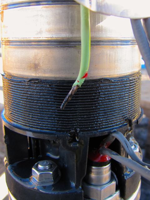

    As removed from well casing; photos showing exactly the well pump, and pump wires at pump, and the electrical splice connection for the well pump. no arrestor.
    The upper casing of well pump was loose and would slide up and down. Why would the pump shell separate and this caused the pump wires to short out?
    It was a Gould Bruiser Pump.
    "This Forum Rocks!"
  12. #42
    Apr 2012
    ct
    218
    I like the drop of blood on the ground wire.
    Bruiser, what a piece of shit pump if there ever was one. I have pulled them when they were junk after less than 5 yrs.
    Notice how the plastic threads are destroyed? It looks as though the pump locked up and spun the jacket. Another good reason to use a pump with stainless ends.
    Tape splices are ok if done correctly, but that takes more time & costs more than using a heat shrink, so why do it?
    A lot of guys don't use a torque arrestor in pvc wells, but I think it is a good idea and good peace of mind for an extra few dollars.
    Your wife has the patience of a saint to go this long without water.

  15. #45
    Jan 2013
    Santa Fe, NM
    29
    I'm trying my best, and with the help of you all in forum, this well will be up and running very soon.
    The bad weather the other factor, not a simple project,
    Thank you God!
    All is covered now.
    Just waiting on the new pump and other parts now.
