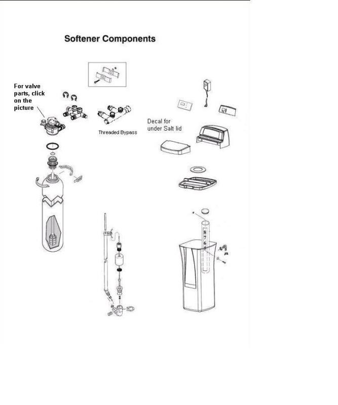

    I have a whes30 water softener and have been trouble shooting it for a while as the 'softness' has vanished. I know the venturi is working as I disconnected the line from the fitting and there is a suction there, I also blew through the brine tube and bubbles were heard in the brinewell, my water flow indicator is showing the moving 'drops'. Checked the turbine in the outlet tube and it's not locked up. Did all the manual regen. checks and that checked out. My water softener was set at 25 which worked good, reset at 50 and still no soft water, I think it's not regenerating at all as the salt level has stayed the same the past couple of days, could the board be bad? Is there some sensor not activating the water softener automatically, though I can do it manually? Thanks for your help.

    You may want to check the o ring that seals the distributor from the valve. I have seen then end up in the upper basket which the unit will function properly but no soft water. Or you could have a salt bridge.

    Thanks all for your suggestions, I know it's not the' board'. As I stated before, if I disconnect the brine line to the venturi there is suction at the fitting and I can suck brine up, the discharge water during the brine cycle is fresh not salty tasting.I did a manual regen. and it does go through the cycles, and salt is being used, except no soft water. There's no salt bridge, if the 'o' ring is bad as you suggest would that cause an insufficient draw or no draw of the brine? Thanks for your suggestions.

    If the o ring is bad, the unit will work as it suppose to. The water simply will not pass through the resin.

    I'm on private well and no chlorine is present, I assume by the 'o'ring you are refering to the large 'o' ring, 3-3/8"x 3-5/8" with the rotor and disc assembly.. There are two smaller o rings under the valve cover. The unit is 2 years old. Thanks.

    The o ring I'm referring to is on the bottom of the valve. Where the distributor tube connects to the valve, there is an o ring to seal the raw water from the treated water. If the o ring is missing or out of place the water enters the resin tank and then passes between the dist tube and valve without going through the resin.

    ok, I think I follow you and I'll check that o ring. in the whes30 manual it's listed as# 1 on page 24, I would enclose picture but not having luck doing that. Thanks so much for your help.
