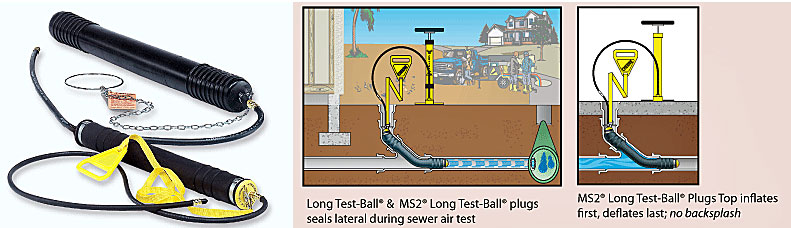

I may have found something that could answer my first question. I found an inflatable plug that I could stick into the pipe provided I have a wye installed. I attached a picture of it to this post. It wouldn't test the ABS to CI interface but it could do the rest without the need to detach just for the test. I still haven't found anything on Q2. Thanks

I like using a test tee and one of these
If you are using a wye, then the test ball should be longer. The long ones are a bit tricky when they deflate though. For one thing, there isn't anything to prevent them from slipping down the drain farther, and you can get pretty wet if you're not careful.

Thanks Terry, that clean-seal looks perfect and I'll see if I can find one.
