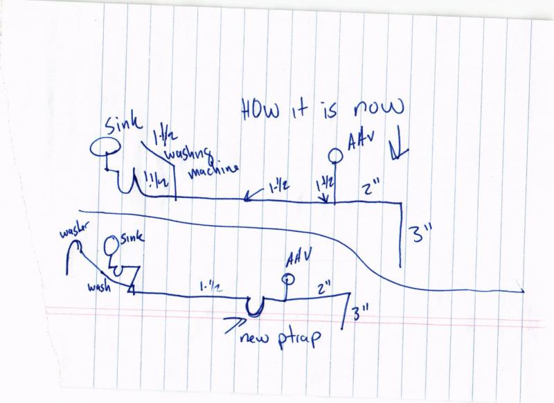

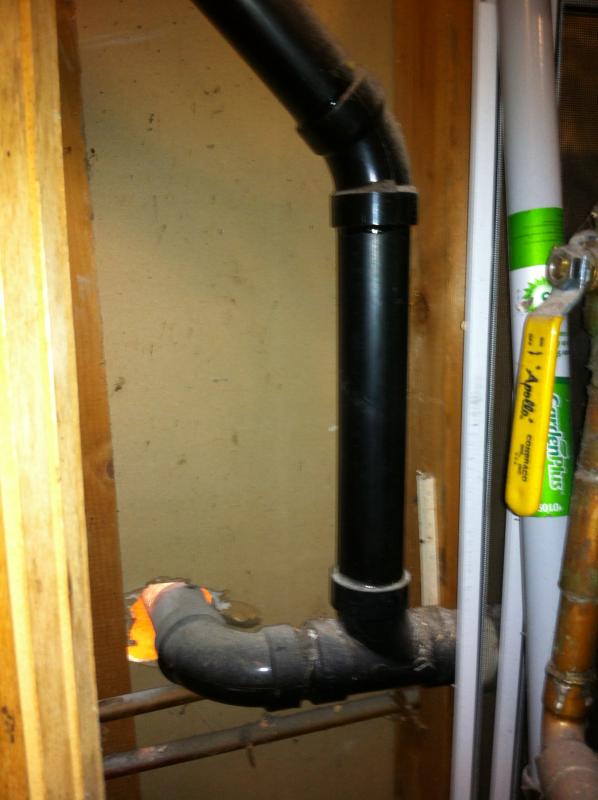

    Hi while doing a remodel i notice that my washing machine has no trap, it shares a drain line with the bathroom sink, the sink has a ptrap under the sink but there is not one for the washing machine. They both have a 1-1/2 inch pipe which is goes into a 2" with a aav then in to a 3" into the main sewer line. My questions are does the washing machine need a 2" pipe, and if not can i just put a ptrap down the line from both drains to fix the problem. I am attaching a picture of the connections and a drawing of how it is set up.. thanks. I can upload a video if it will help.. Name:  IMG_3771.jpg

    IF that piece with the 45 on it is the washer drain, then it DOES need a trap, but NOT like you show putting one in.
    Jan 2008
    3,154
    The fixtures must be trapped individually and each trap will need it's own vent. A proper laundry drain is 2" What you are proposing with the running trap would not be approved anywhere in the U.S.A.
    There are several good threads with pictures here in the forums showing how to properly plumb a washer. Take your time and look around.

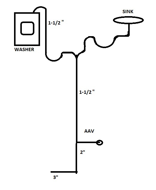

    Okay so i need to remove whats there and go with a 2" for the washing machine, that is fine, before i do i want to make sure what im putting in is code or as close as I can get.. don't want any problems in the future. i have made a drawing of what im thinking about setting up.. drawing is looking down on the pipe.. please let me know if this will work?.. thanks.

    AAV's are not allowed everywhere, the drain system needs at least one atmospheric vent, and if there's a reasonable way to vent what you're doing atmospherically, the inspector will probably require it to be done that way. An AAV is mechanical device that will eventually fail, needs access for that eventuality, and doesn't work in all situations. It can only let air in, and a washing machine's pump may end up pressurizing the pipe with no place for that air to go, thus, the AAV won't work and you'd end up gurgling and spitting in the lav sink.

    There are several vents in the system going out the roof, at least 3, main, kitchen and bath.. do i still need to add one to this part of the system?
    25,659
    You have to understand that an AAV can CAUSE as many problems as it cures, depending various circumstances that can occur over time. IF you installed it EXACTLY as you have drawn it, you would create TWO "running traps". Actually, that "washer drain" looks like it was originally the vent for the sink so there may be a pipe that it was connected to at the ceiling somewhere.

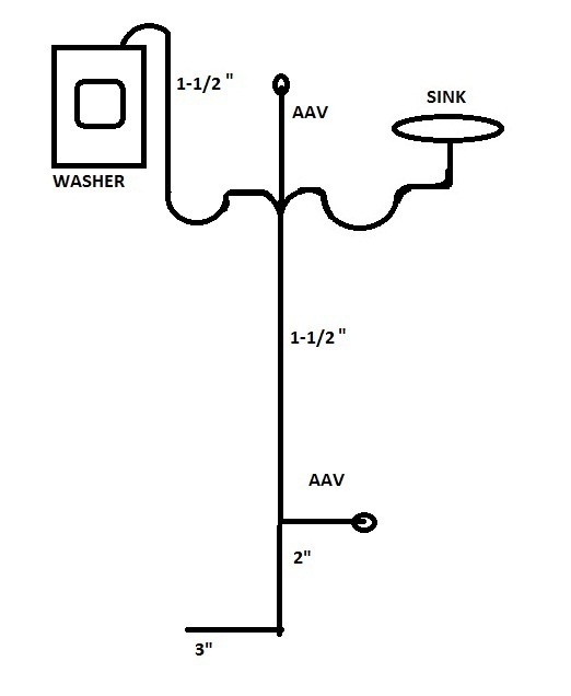

    how about this?
    i think this will be the quickest way ..

    EACH fixture needs it's own, separate (they can be combined higher, if done right) vent. No, that is not better. Often, the easier route does not work.

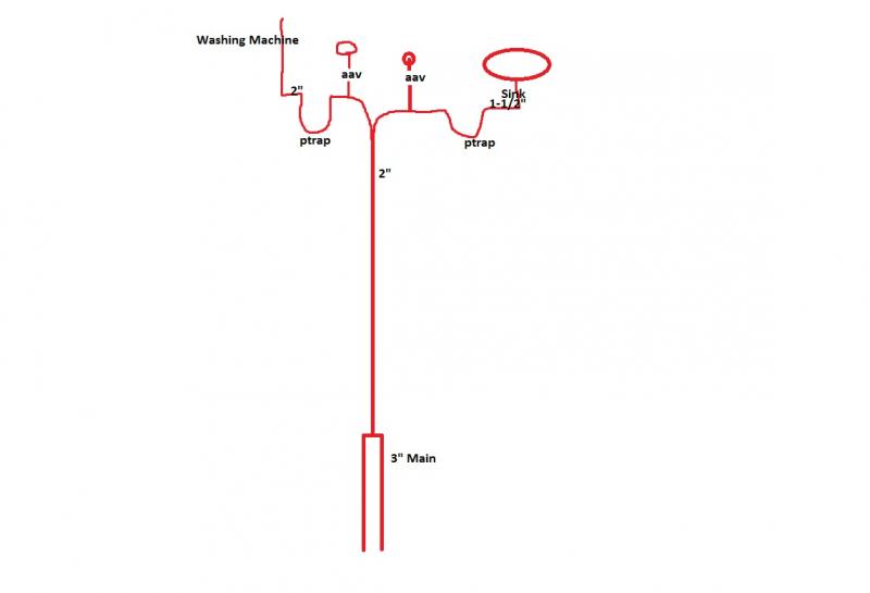

    I talked to a local plumber and he said i could do this.. any thoughts.. thanks.

    Your drawing does not portray the actual layout very well.
    There is little to say you would not be allowed to connect it in that manner, if the washing machine standpipe and branch drain were all 2", and someone made a double-fixture fitting in that size.
    If the line ever becomes restricted, the washer is going to pump it's entire load into your bathroom.
