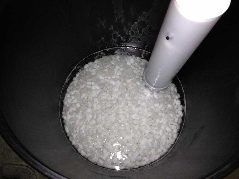

    I just check the brine tank and found the water were covering the 3 bags of 40lbs salt. Is that look right?

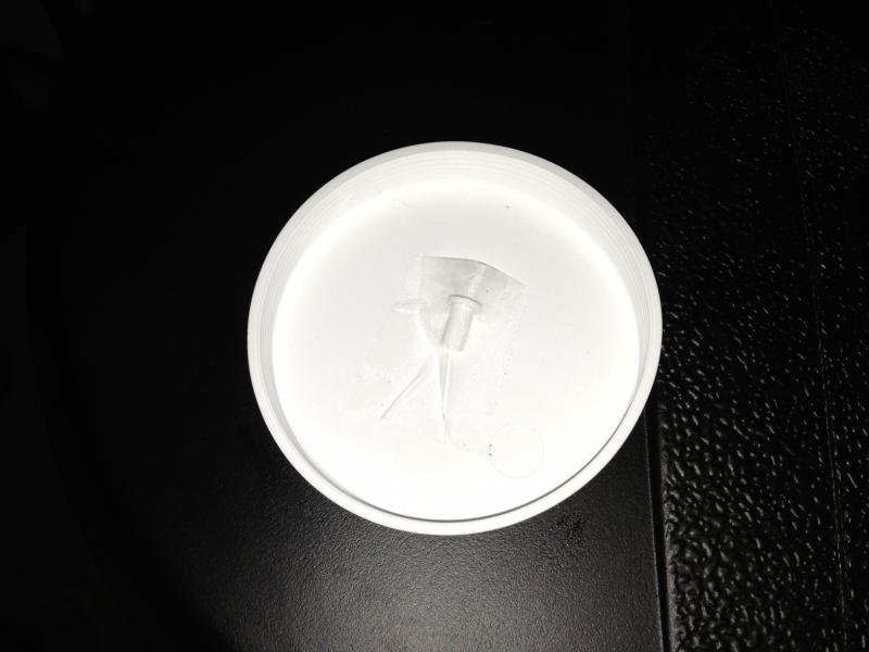

    I also found this on the brine well cap. It looks like part of brine fitting assembly were it should be install on the end of brine line tubing. Is that the reason why there are so much water in brine tank?

    That is a tube insert. Most tanks come with one in the tube and an extra on the cap in case it gets lost. We sell those in 1000 min. order qty's, every service guy usually has those in bulk on their service truck, in their pockets, in the glove box, on the floor board... It is used to reinforce the tube connection for Jaco or compression style fittings. I would take it off and throw it in a drawer. You will know if the system is working properly if it draws brine during the brine and rinse cycle. your brine tank should have around 5 gallons of water in the brine tank when it refills. Dont forget to add approx. 3"s for the aircheck assy.

    There are more than 5 gallons on water in the brine tank. I'll do another regeneration tonight. I think if I wanna decrease the water in brine tank, perhaps I can lower the BF to 10 so It will decrese the water by 3 gallons if my default was setting at 22. right?

    The water level in the brine tank is usually calculated -3" to accomodate for the airrcheck assembly in the brine well. If you regenerate it, you will notice the water level will not drop all the way to the bottom. It is like having a straw in a glass, but it is off the bottom slightly.

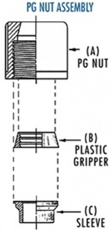

    Sounds high. Take a look at the picture, remove the brine fittings from both ends of the brine tube and make sure the Jaco Style fittings are assembled correctly as shown. Also, if the tube does not have the insert you mentioned earlier, insert it into the tube. It helps make a better seal. Keep me updated as to what you find.Name:  jaco.jpg
