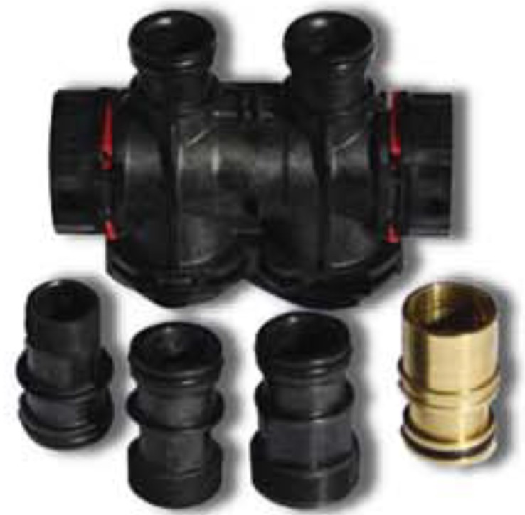

    The 7000 only has 1 bypass, it is a 1-1/4", the plumbing connectors are what make it the different size. See the attached picture for details.Name:  bypass.jpg

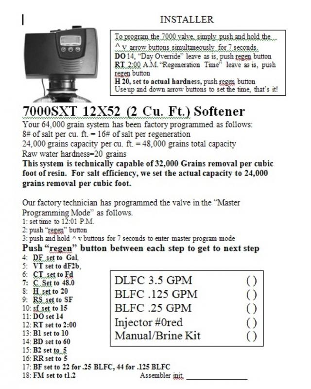

    Hi Dittohead,
    Can you send me the cheat sheet setting? I prefer good water quality over salt saving
    hardness 21gpg
    iron none to very low
    manganese none to very low
    chlorine 0.7ppm
    Family of 3 adults + 1 baby with 3 full bathrooms. The water usuage is about 220 gallons per day on average base on my current water softener.
    The new water softener is Fleck 7000 SXT 2 cu ft with 32mm districbutor using 1-1/4" copper pipes.
    Many thanks
    Jan 2012
    1,083
    Name:  7000 2 email.jpg
    Set H to 21, the rest will remain the same. Congrats on the new system!
