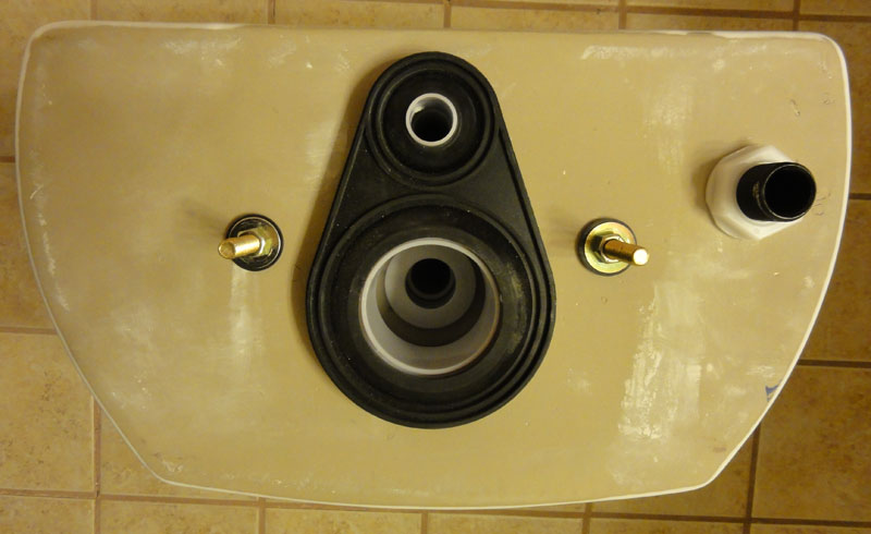

The hold closest to the wall is for the vacuum assist.
The bottom of the Stealth tank
Rubber seal between tank and bowl

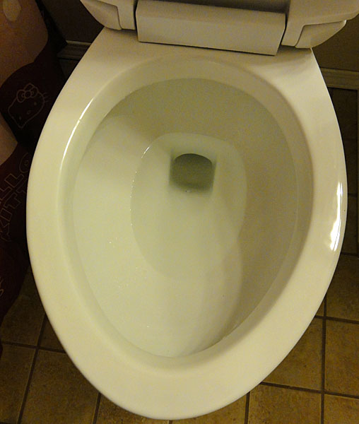

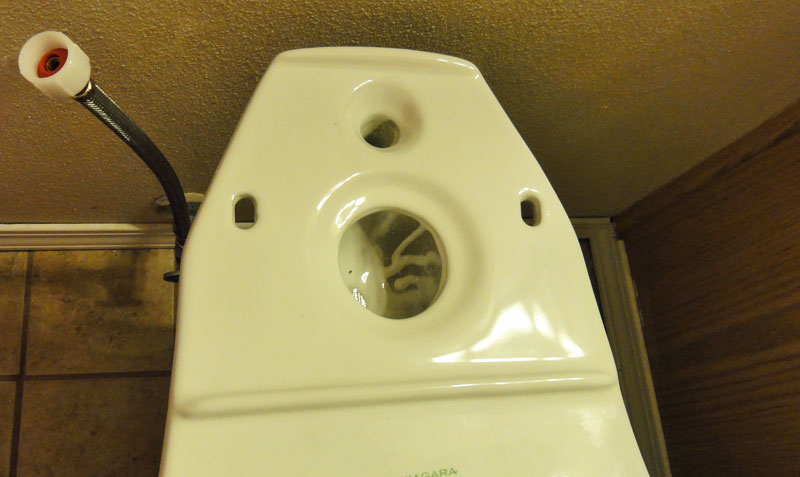

Below are pictures of my Niagara N7717, which I recently purchased, and am just about to install.
On the inside of the bowl, near the entrance to the trapway, there is a "dimple" in the porcelain. See the following picture, with the dimple shown in a red box:
When I first saw it, it looked like a manufacturing defect. But, in Terry's photo above, titled, "The bowl with water", it looks like that N7717 that he installed also has the same dimple, in the same location.
Does anyone else have any experience with this toilet, and can comment if you have seen any other Niagara N7717 toilets with that dimple in the porcelain?
Terry, any comments from you on this dimple? Do you recall if there was, in fact, such a dimple on N7717 toilets that you have installed?
See some additional photos below of this "dimple" on my N7717.
Because it looks like the same dimple is on the toilet in Terry's photo above, and given that it is unlikely that the dimple would not have been noticed by those at the factory who manufactured and packaged the toilet, I am concluding that the dimple is most likely normal, and is not a defect or cause for concern. So, I will most likely install the toilet, and hope for the best.
Thanks for any additional insight or info anyone can provide on this.
The following photo is a close-up, showing the detail:
I don't have the bowl in front of me, but I think the hole should have been punched out. Can you look under the bowl and see if there is a pathway to that location for water from the tank?
That might be a siphon jet hole.
jmiah
Appleton, WI
Hi Terry, thanks much for your reply. That does make sense, as the other two toilets I have in my house both have a larger hole in that area, for a water jet (the other two toilets are older, and a different brand). And, I can't think of any other reason why that dimple would be there on my Niagara N7717.
Below are a couple of photos of the underside of the bowl of my N7717. The two photos are the same, but in the second photo I put a red circle in the area where I estimate that the dimple is on the other side (i.e. inside the bowl).
To me, that area does look to have a pathway for water from the tank. Do you agree?
So, most likely a manufacturing defect on my toilet bowl?
(I haven't installed it yet.)
The "dimple", shown in the photos in my earlier post above, is approximately on the other side of the following area circled in red:
jmiah
Appleton, WI
Terry, I did a little more research, and your initial assessment above, that the "dimple" in my toilet is a siphon jet hole that should have been punched out when the toilet was being manufactured, is almost certainly correct.
Here's a link to a page on Niagara's website on their Stealth toilet technology, which includes the statement, "The siphon jet hole is smaller than a typical toilet and is located in an area where it can quickly force water from the bowl into the trapway.":
https://niagaracorp.com/stealth/
So, that also answers one of SamC's questions above; yes, the Niagara has a jet at the bottom of the bowl....but, not a working one on the Niagara that was shipped to me :-(
So, now I see that the the siphon jet hole on mine definitely has a manufacturing defect, and I am sure that would prevent the toilet from functioning properly/optimally. I am going to return it to the store, for sure. Now, I need to decide if I will get a replacement of the same Niagara toilet, or buy something else...
I was hoping to have my toilet install completed today, but I am very glad to have figured out the issue *before* the toilet was installed. Thanks so much for your help, Terry!
