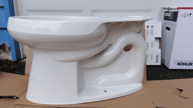

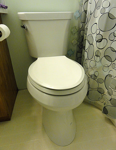

    The Kohler Highline® K-3999 comes with a taller comfort height bowl, elongated with a 1.28 GPF tank that meets the WaterSense requirements.
    Kohler Highline.

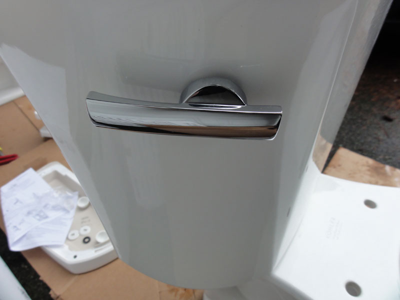

    The new handle of the plumber's version of the Highline.
    Looking at the side of the K-4199 bowl.

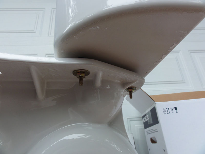

    The tank attachments

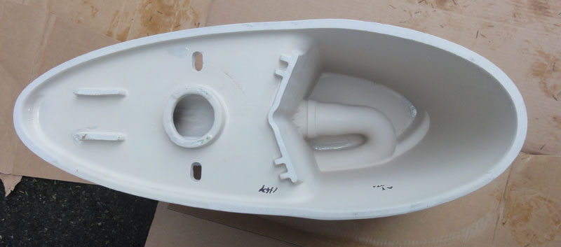

    Bottom of the K-4199 bowl
    The fit and finish looks pretty good from here. Was there any notable defects or issues?
    Would like to get my hands on one of these to test out but nobody but the big box sells Kohler in this area.

    The original Class Five lacked the bowl wash at the back. That was changed years ago. These pictures are of a new bowl and tank, and the rinse is 360 around the bowl.
    The original Class Five had a 3-1/4" flapper. The new class five uses a smaller flush valve, a llittle smaller then 2"
    The trapway is better then the old Ingenium, and the ratings show that.

    The original Class Five® had a 3-1/4" flapper. The new class five® uses a smaller flush valve, a llittle smaller then 2"
    So is it correct, then, that the original Class 5® wouldn't take a generic 3" flapper and flush valve, because it was too big, and the new Class 5® won't take a generic 2" universal flapper and flush valve (too small)?
    Thus forcing people to use Kohler® OEM parts. For no functional reason.
