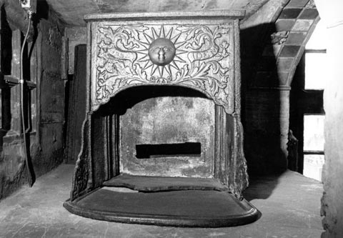

    Ben Franklin knew this some time ago...
