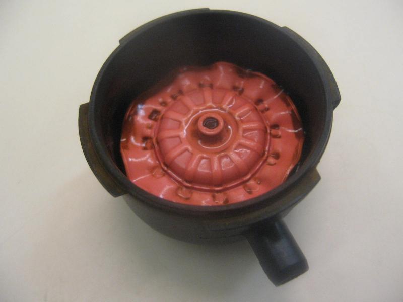

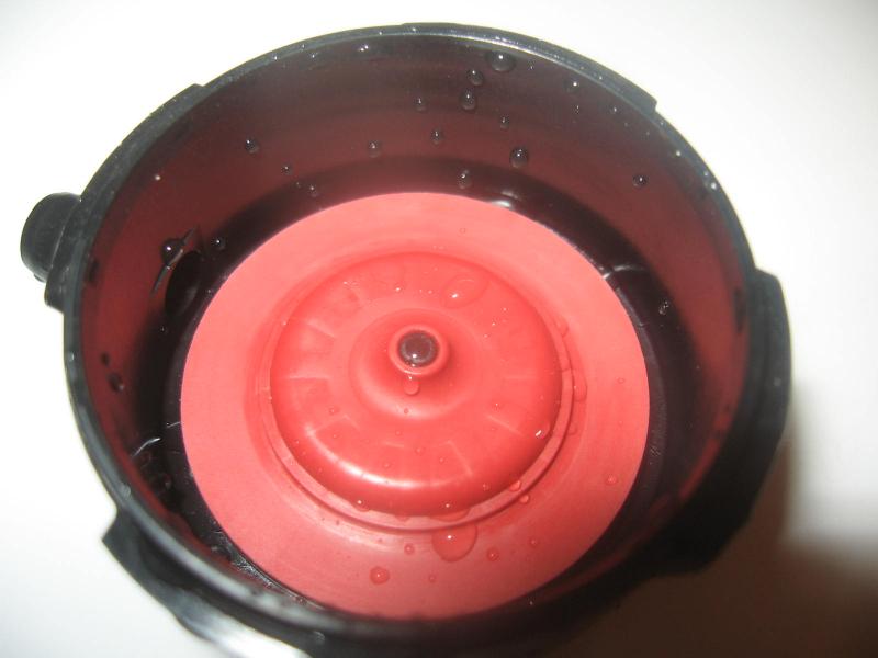

    Actually, I think it's the same cap except one is beat to $&!^. In your photo, you can see the tool marks in the new one which have resolved in exactly the places as the old one, just not as deep.
    Answer -- it was the cap. And now you have a complete valve if you ever want to replace any other parts except the float. For that price, I'm guessing they sold you the white-cap 528, but all you needed was the cap. If you got a 528MP, then you got a really good price.

    Quote Originally Posted by Maxxsounds View Post
    Went down to my local plumbing supply house today. They had the whole valve on sale for $7.99 so I bought it. They did not have just the cap. Anyway, after swapping out a few different pieces, I got a functioning valve. The caps were quite different from each other as you will see in the photos. (I don't know what the original cap was supposed to look like new) I had to use the old float. The new float did not fit in the old housing correctly for some reason. thanks for your help guys.Attachment 18548 Attachment 18547
    Wow that cap that was in there looks horrible for 2 years! The Korky in one of our Drake's is going on 7 years old with the original cap and still looks more like the new one you showed a photo of! Your water pressure must be very high, or perhaps it's something in that dirty water that didn't like the rubber much!
