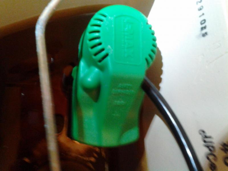

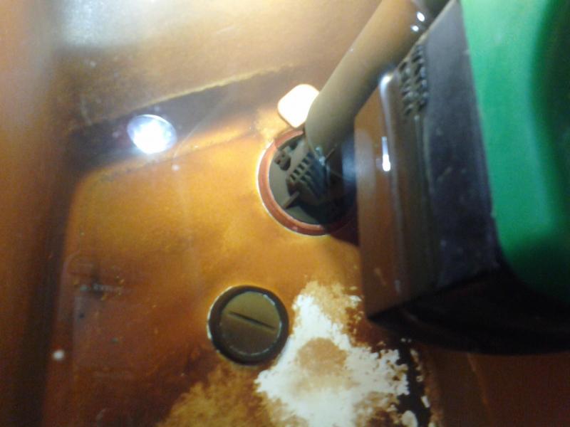

    Thank you for the quick reply. The fill valve on my drake looks different than the one you have shown there. Attached is a photo of mine.
    I am trying to determine if the symptoms warrant pulling the valve out.
    The volume of water coming through is as strong as before, it just cycles on and off quickly. If the filter on this valve was clogged, wouldn't there be a reduced volume of water coming out?
    If I partially close the valve on the wall behind the toilet while it is filling, the cycling stops and I get a steady (less volume) stream of water. Thanks again, you guys rock!Name:  toto drake #2.jpg

    What you have is the Korky fill valve.
    A replacement for that would be the Korky MaxPerformance.
    Or, you can remove the black fill tube, and pop the green cap off.
    Under that you have a float and a cap. Remove the float, spin off the cap, counter clockwise. You may be able to clean that or replace the cap.
    Assuming that you are overflowing the tank into the overflow tube.
    If it's just refilling because of a leaking flapper, deal with that first.

    Where does your water come from? That tank is filthy for just 2 years. That would be what a tank that was in service for 40 years around here would look like, at worst.
    Jan 2008
    3,140
    That is what a tank looks like when you have iron in your water.
    DIY Junior Member Maxxsounds's Avatar
    Jan 2013
    Idaho
    Quote Originally Posted by gusherb94 View Post
    Ha, Boise,ID there sir. ALL city water is that way. That brown is iron deposits. When you pull the screens off the lav faucet, you come up with about a half a teaspoon of little white pellets, kinda looks like kosher salt. Don't know what that is.

    Remove the rubber tube and pop it open by lifting up on the little green tab on the leftmost edge of your bottom photo in the post that the forum software has labelled "#3".
    If all else fails, this valve (Korky MaxPerformance 528MPK) for $10.47 at Lowe's is the replacement, and takes about 10 minutes to install: LINK

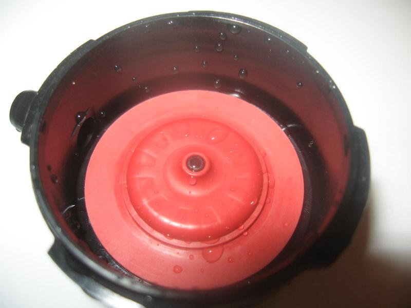

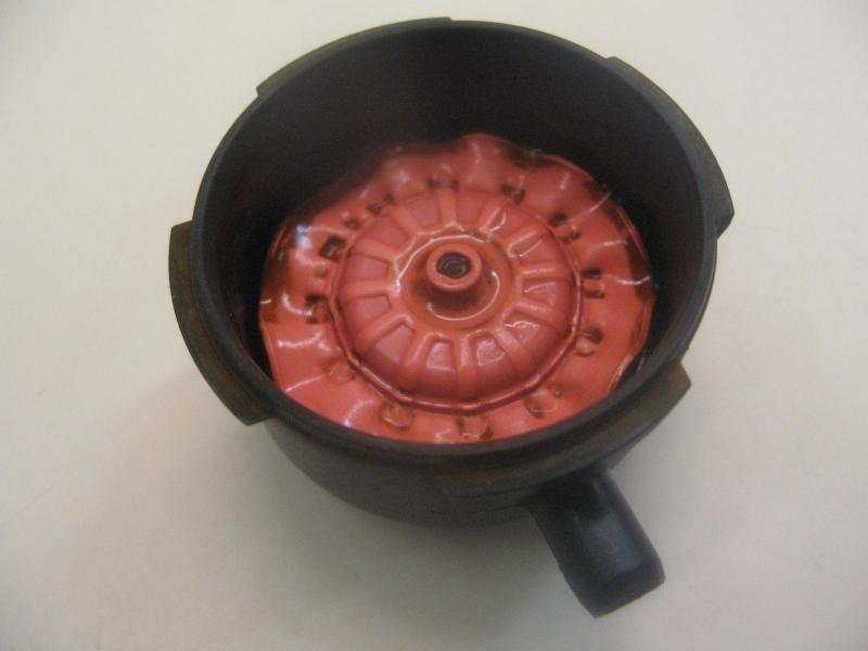

    Went down to my local plumbing supply house today. They had the whole valve on sale for $7.99 so I bought it. They did not have just the cap. Anyway, after swapping out a few different pieces, I got a functioning valve. The caps were quite different from each other as you will see in the photos. (I don't know what the original cap was supposed to look like new) I had to use the old float. The new float did not fit in the old housing correctly for some reason. thanks for your help guys.Name:  toilet fill valve cap old.jpg
Size:  32.1 KB Name:  Toilet fill valve cap new.jpg
