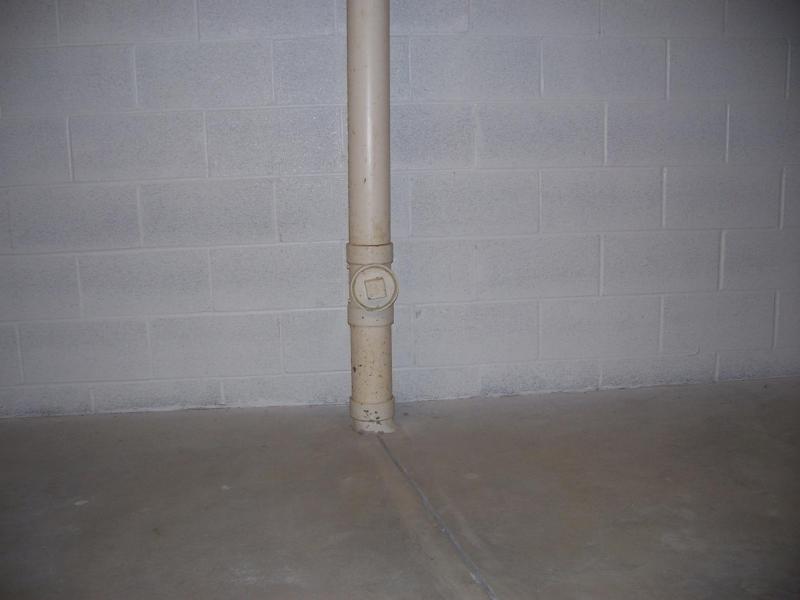

There is a round disc on the side of the pipe and it is tight so I pretty sure the water is not coming from there. .
Besides the color difference is this what your stack looks like?

From your description, it does appear that this is you main drain stack and the "disc" is the cover for the clean-out. If the pipe is plastic, it is ABS which is made from different chemicals than PVC, but is commonly used for drains. As noted, the cover screws into the tee, and it could be loose. It is also possible that the tee has a small crack. I would suggest you monitor this closely and try to determine where the water is coming from. If it is a cracked fitting or while unlikely, a bad joint, it would be a job for a plumber. There is no dependable patch than can be applied to PVC or ABS, it requires replacement. Not a real difficult job for a plumber, but for a novice DIY, you could find yourself in trouble and have to hire a plumber anyway. I realize cash is a problem, but sometimes it's cheaper in the long run to get a professional in the beginning. Look especially carefully around joints where the pipes are connected either to another pipe or to the tee fitting with the plug. If it is leaking around the plug you might try tightening it, but don't overdo the force. The bubbling at the DW could be the signal that the drain needs to be cleared and that requires a plumber too. Don't just pour liquid drain cleaner into it. They don't work or real clogs.

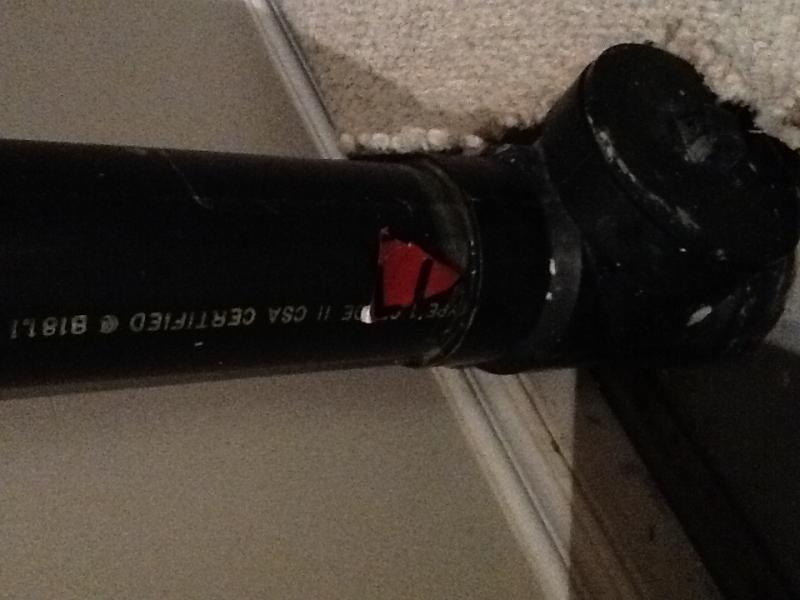

The water is coming from the upper join in the outer casing just above the disk. You ca see the red paper arrow pointing at the water. Hope this helps. Thank you

If the water isn't running down the pipe and just ending up on that joint, it means that your pipe is probably clogged and they also didn't do a good job gluing that joint. If this is the case, that whole pipe could be filled with water.
The cap could be removed and that line could be snaked (I would get a pro for that). However, you will need something ready to catch the water as there could be several gallons sitting in that pipe (or may not depending on the clog and how much that drain gets used). If you were going to open it and clear yourself, I would probably wait a couple days and not use anything that might drain into that stack. This should allow the water to drain unless it is 100% clogged. You would still want to be ready with something to catch the water (and may be nasty stuff with kitchen and toilet waste in there, so be prepared).
