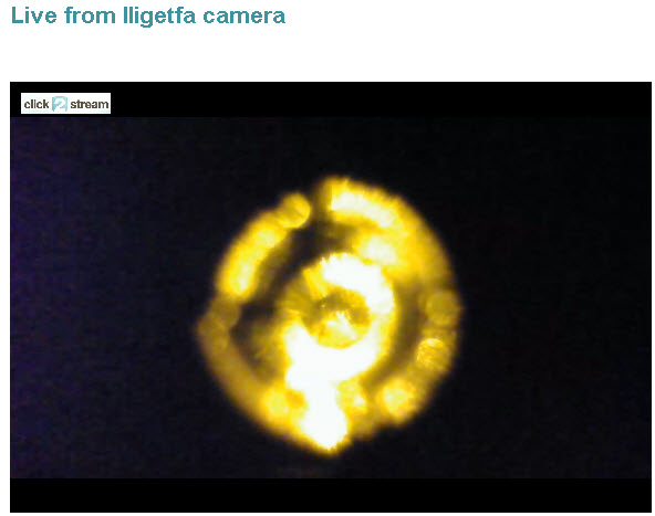

    I was having a problem with my new furnace so I put an IP cam on it facing the status indicator. I hosted it on Click2Stream and can look in on it at any time. Not much to look at but I can see the status from anywhere.
