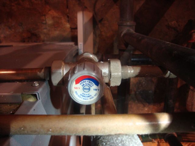

    Thanks for the response. I've always been a bit unclear on exactly why separate controls are not allowed. I am pretty sure I do have a mixing/tempering valve just off the boiler connected to the hot water line, and the water never gets extremely hot even when I have only hot on. I have included a photo. In that case would it be possible to replace the entire valve if the seat cannot be removed??? The plumber that looked at it had indicated this was not an option because it would be against code. But perhaps if I show him there is already a mixing valve in place it would be ok? Let me know if I am incorrect about the image below being a mixing/tempering valve.

    I think, to qualify, there must be a tempering valve for the specific fixture, not for the whole house (although that is also a good idea and required where I live). The valve at the WH outlet is typically set around 120-degrees F, the safety stop for a tub/shower is usually 105-degrees or so (but can be overridden). That extra 15-degrees or so can mean the difference of being scalded or not. Children and older people have thinner skin and can get second degree burns at 120-degrees.

    OK, got it. Thanks for the information about the tempering valve being required for the specific fixture. In that case is it possible to simply add another tempering valve for the hot water control in the shower/bath and resolve the issue that way?

    If the tempering valve prevents scalding, you're Golden.
    My mothers 95. I installed her's at the water heater in case she takes a bath.
    She also has pressure balanced showers, but that's no help if she uses the deep tub. That's what the tempering valve was for.
    21,382
    That low a water temp is insufficient for things like the dishwasher (unless it has a water heating feature, some do) which doesn't work well unless the water is like 130-degrees or so. Most people don't use hot in the washing machine, but 105 won't make even the warm setting very warm. So, from a practical point, a whole house tempering valve may not be the greatest solution for solving the bath fixture, even if code isn't impacted.
    Just to be clear. When you say "you're Golden". Do you mean it in a general sense as far as safety, which is good of course? Or are you saying that with the whole house tempering valve in place I don't need to have an additional tempering valve for the specific fixture (the hot water valve at the bath/shower in this case) to meet code.
    Thanks.
    14,191
    Gold is good.
    UPC 414.5
    Limitation of Hot Water in Bathtubs and Whirlpool Bathtubs. The maximum hot water temperature discharging from the bathtub and whirlpool bathtub filler shall be limited to 120 degrees F, by a device that conforms to ASSE 1070 or CSA B125.3. The water heater thermostat shall not be considered a control for meeting this provision.
    UPC 418.0 Mentions pressure balance, thermostatic, or combination pressure balance/thermostatic mixing to prevent scalding and shower shock. And again mentions a 120 degree limit.
