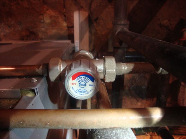

    Thanks for the response. I've always been a bit unclear on exactly why separate controls are not allowed. I am pretty sure I do have a mixing/tempering valve just off the boiler connected to the hot water line, and the water never gets extremely hot even when I have only hot on. I have included a photo. In that case would it be possible to replace the entire valve if the seat cannot be removed??? The plumber that looked at it had indicated this was not an option because it would be against code. But perhaps if I show him there is already a mixing valve in place it would be ok? Let me know if I am incorrect about the image below being a mixing/tempering valve.
    19,395
    I think, to qualify, there must be a tempering valve for the specific fixture, not for the whole house (although that is also a good idea and required where I live). The valve at the WH outlet is typically set around 120-degrees F, the safety stop for a tub/shower is usually 105-degrees or so (but can be overridden). That extra 15-degrees or so can mean the difference of being scalded or not. Children and older people have thinner skin and can get second degree burns at 120-degrees.

    OK, got it. Thanks for the information about the tempering valve being required for the specific fixture. In that case is it possible to simply add another tempering valve for the hot water control in the shower/bath and resolve the issue that way?
    12,596
    If the tempering valve prevents scalding, you're Golden.
    My mothers 95. I installed her's at the water heater in case she takes a bath.
    She also has pressure balanced showers, but that's no help if she uses the deep tub. That's what the tempering valve was for.

    Gold is good.
    UPC 414.5
    Limitation of Hot Water in Bathtubs and Whirlpool Bathtubs. The maximum hot water temperature discharging from the bathtub and whirlpool bathtub filler shall be limited to 120 degrees F, by a device that conforms to ASSE 1070 or CSA B125.3. The water heater thermostat shall not be considered a control for meeting this provision.
    UPC 418.0 Mentions pressure balance, thermostatic, or combination pressure balance/thermostatic mixing to prevent scalding and shower shock. And again mentions a 120 degree limit.
    19,395
    The advantage of a modern pressure balance or thermstatically controlled valve is that should there be a condition that disrupts the flow on one side or the other, the temperature doesn't change much. On a pressure balanced valve, a sliding valve called a spool valve moves towards the low-pressure side, shutting down some of the flow from the higher side, maintaining the relative volumes of the hot and cold which keeps the temp fairly even. A thermostatically controlled valve uses various means to maintain the outlet temperature based on varying inputs. A tempering valve external to this arrangement will limit the max temperature that can be released, but will not prevent the potential shock of going from 'normal' showering temperature to a potentially near max or quite cold spurt. that is where a modern anti-scald valve comes into play...it is safer since the shock of a wide temperature variation can be as disruptive as an overtemp situation.
    So, limiting max temp is only part of the safety issue, but may be enough to pass local code inspection. Maximum safety calls for a newer valve...your level of comfort may vary.
