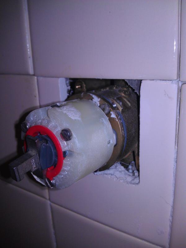

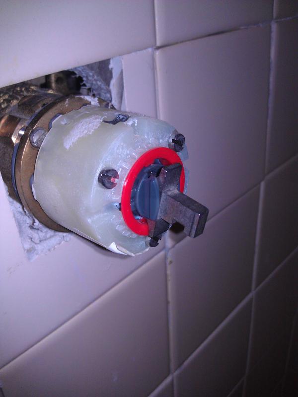

    I am trying to identify the make and model of this shower valve to identify a replacement fixture. my searching hasn't yielded anything online. The shower head was a peerless, but i have not found anything in their catalogs to match the valve. the valve has "PMORE" on the right side.

    Thanks for the help.

    American Standard
    go to www.alfanoplumbingparts.com, single handle cartridges, compare the dimensions and gasket patter on the bottom.

    857
    American Standard
    go to www.alfanoplumbingpartrs.com, single handle cartridges, compare the dimensions and gasket patter on the bottom.
    If you can't make that link work, there's an extra r in "parts.com". Then you'll see Alano's pretty-comprehensive catalog.

    Thanks for the help, that's exactly what I needed.
