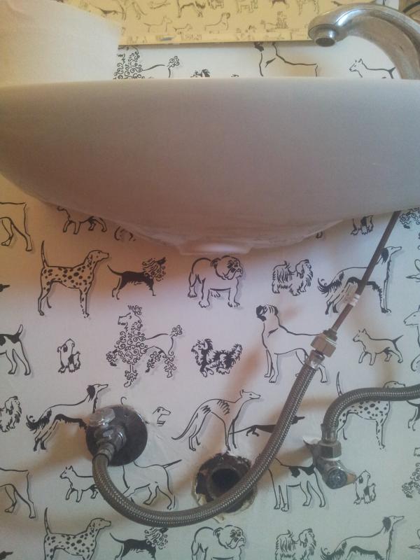

    I'm trying to do the drain for a "Porcher Elfe" no-overflow sink. This is a very narrow sink (for our very narrow half bath) - the drain hole center is 3.5" away from the wall. I first removed the chromed brass wall piece that stuck out quite a way - thanks to searching and reading previous posts, I was able to identify and remove the solder bushing in my CI stack, by hacksawing out a section.

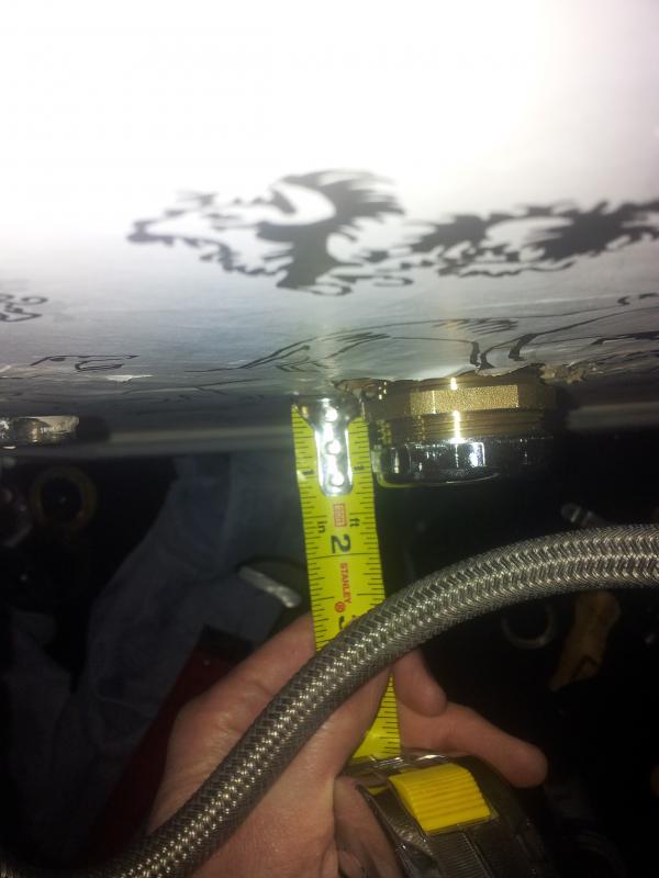

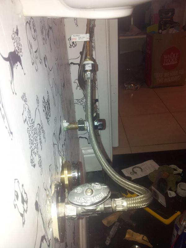

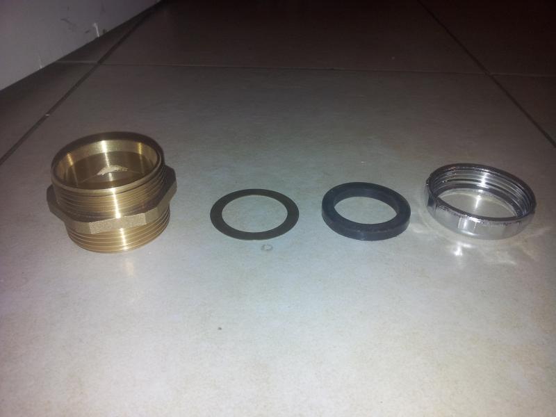

    My thought was to use a bottle trap, as that seems to be what's in all the pictures I could find of these european style hand-rinse sinks. Unfortunately, the sink drain is 1/2" offset from the wall opening. I'd love to avoid moving the sink if possible (wallpaper cut/installed around the existing location), and the local plumbing supply sold me a brass 1-1/2" to 1-1/4" trap adapter with rubber washer and slip nut - he said it would likely maintain the seal while allowing the 1/2" offset to the bottle trap. After screwing it into the wall, I'm not sure there will be room - haven't bought the bottle trap yet.
    Is this a viable route? Other thought I had was trying to somehow link up a "double offset" to the drain, to allow a p-trap to come back in front of the DWV. But this or other p-trap options seem like they might be pretty ugly in this exposed location compared to a bottle trap. Also, if I do screw in a brass adapter into the cast iron, do I need something on the threads?
    I'll try to include some pictures of the situation. I appreciate advice!!
    btw, I plan to replace the left shut-off valve with the right angle style that is on the right.

    That is a 1 1/2x1 1/2 trap adapter with a reducing washer, so it SHOULD accomodate the offset, but all you can do is install it and try it out.

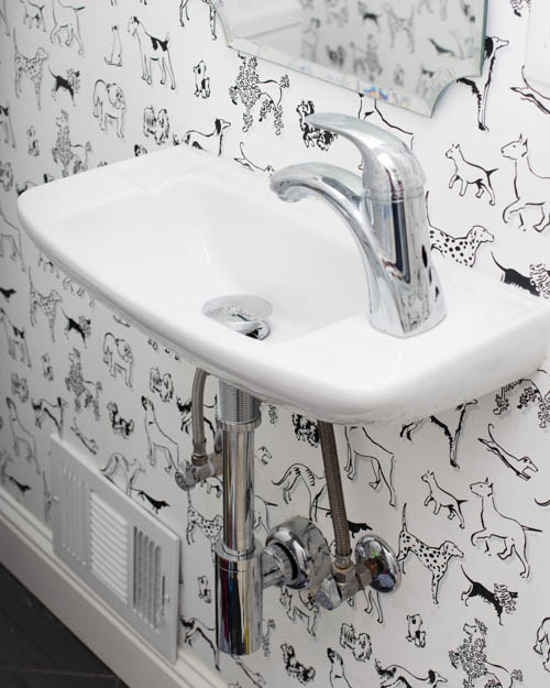

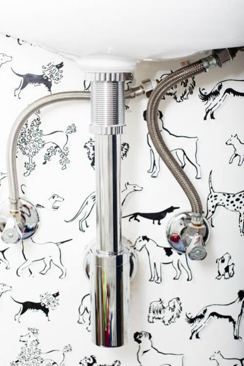

    Well, it seems to have worked! The first time I tightened things up, I got a little leak from where the sink mates with the drain gasket - I had a thicker gasket so I used that and tried not tightening it down so hard. That seems to have solved that. None of the sections I thought might leak did! Used pipe dope for the brass to iron, and tape on all the other threaded connections. There was enough play thanks to all the gaskets that everything tightened down and lined up nicely. I'll include a couple pics. Thanks for the help!
