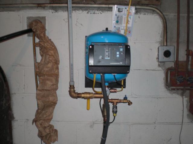

    Attached is the way I have my system set up currently
    I have one of these for a switch, and its adjustable with a allan wrench up top.
    This is the specs on the tank we have.
    Ok so now my question! I was fiddling around with that switch when the water was turned off, and moved it from the factory setting of 50. I fiddled with it more when the water was back on, and have it sitting at almost 55 psi on the guage. I checked the tank pressure with the water off and it was at 30 psi.

    I gotta ask, who installed the tank and fittings?
    A 3' loop in the pipe shouldn't be an issue as long as the loop isn't verticle and into the frost line where it would freeze.
    The correct pressure for the tank with Constant Pressure System should be 70% of shut off pressure. So if your shut off is 60psi, you want 42 psi in the tank. To do that, shut off the pump and drain the tank then set your air pressure through the schrader valve.

    Well, I would get rid of that Chinese tank and use a Well X Trol product along with a real tank tee. I mount the tank on a board which I then shoot to the wall with a ram set gun. After that is nice and level, your pex will look infinitely better.

    Yours is a Flexcon tank, considered #2 in the industry because it is a copy of the Amtrol design. Don't replace it until you have to.
    Craig, if you have ANY sediment in the system, you will have trouble with that pressure transducer being on the bottom of the tee.

    I appreciate the input Valveman, the system has been in there 4+ years with no problems what so ever. As for the tank, I have little faith in anything made in China......
