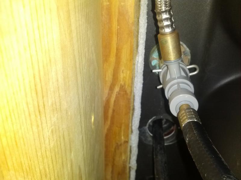

How to un-connect a kitchen side spray hose from a plastic fitting under the sink
Tom Hoffman
Orangevale, CA
The side spray line "keeper" (where the line comes out of the sink hole) broke. To repair it I need to remove the side spray hose. I can't figure out how to un-do the spray line hose. See picture - this is looking straight up under the sink. It is the black line on the right that goes in to the gray plastic fitting. The silver braided line at the top is the water supply. Any help is appreciated.
Tom Hoffman
Orangevale, CA
33,608
1,047
You push up on that "grayish" ring around the brass stub and then pull the brass stub out., although, I would take the spray head apart, and drop the hose down through the guide.
