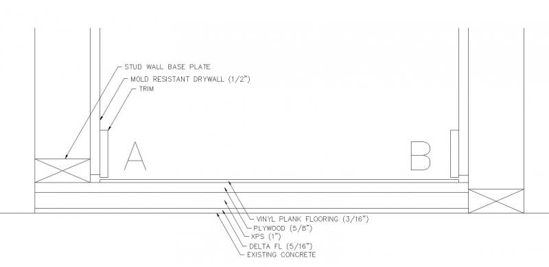

    As I mentioned on another thread, I am preparing to finish my basement. I am considering the following subfloor stackup:
    • Existing Concrete Floor
    • Delta FL Vapor Barrier
    • 1" XPS
    • 5/8" Plywood (Tongue and Groove)
    The finish flooring will, most likely, be vinyl plank in the living areas and ditra/tile in the bathroom.
    I have several questions:
    1. Does this subfloor stackup look reasonable?
    2. Can the Plywood be left floating in the living areas?
    3. Should the Plywood be Tapcon'd through the XPS to the existing concrete in the bathroom?
    4. Should the partition walls be built on top or next to the built up subfloor? (see sketch below). In either case the base plate would be fastened to the existing concrete floor.
    In the sketch below, I've shown "on top" as A and "next to" as B. If A is used, to the left would be an unfinished utility room with a dehumidifier to pull any moisture from below the Delta FL. If B is used, any moisture below the Delta FL have to absorb back into the concrete or into the base plates (which would be treated, of course). The exterior stud walls are in, so B will be used around the perimeter of the basement regardless.
    Name:  wall options.jpg
    Thanks in advance for your replies!

    Don't use DELTA FL and XPS together.
    Frame after you finish the floor, it will be much better that way.
    You will need to tapcon the ply, it wont stay there floating perfectly without.

    A 6 mil vapor barrier would be fine.
    The foundation wall also needs foam between the concrete & studs, as well as between the concrete & sub-floor edge.
    You have serious moisture trap risk to the plywood with vinyl flooring on top, which is also a strong vapor barrier. Using something more vapor open than vinyl for the finish floor is STRONGLY recommended.

    Tile is usually quite vapor permeable, despite being waterproof to liquid water. Cement board provides better rigidity and a better bonding surface for tiles than plywood, which is also important to consider.
    Most laminate flooring is at least somewhat vapor permeable, but get specs on it. Standard hardwood & bamboo flooring also works, and with the foam & poly underneath would only have moisture issues if the basement has flooding problems, which would hopefully be addressed BEFORE you finish it out nicely.
    With an inch of foam you'd have sufficient R under it to avoid summertime condensation/mold issues under the carpet, if you went with a carpeting solution. Without the foam carpet would be all but guaranteed to have rot/mold issues. (Not that I'm a fan of carpeted floors, in basements or anywhere else.)

    Would a thinner insulation (say 3/4") still work under the plywood subfloor?
    In the trades Dana's Avatar
    Jan 2009
    01609
    2,720
    Depends on what you mean by "work".
    At 3/4" XPS is only about R3.5, which is on the thin-side for the ~45F western WI deep subsoil temps, and you may need to use dehumidifiers in summer to keep the subfloor from taking on moisture from the ventilation air. The more R you can get between the subfloor and concrete the better, up to a point. Average summertime outdoor dew points in western WI are in the low 60s, and if the bottom surface of the subflooring stagnates at 60F or lower it'll take on moisture. With a 70F room, 65F floor and 45F slab, you have a 20F difference. If the finish floor + subfloor add up to R1 you have about R4.5 , total or 20/4.5= ~4.5F per R. That means the bottom of the subfloor will be running about 65F-4.5F, or 61.5F or about the same temp as the average . That kinda makes it on paper, but not with a lot of margin. With R5 (or a warmer subsoil temp- can you move the house to Peoria? :-) ) you'd have a bit of margin.
    If you put a dehumidifer down there and keep the most humid rooms under 60% RH all summer it'll have quite a bit of margin.

    Channels do not have any effect on water vapor- channels are about reducing the capillary wicking of liquid water.
    But the materials Ditra is made of make it a class-I vapor retarder, a true vapor barrier, so be careful what you trap underneath it, since whatever that is will end up being nearly 100% saturated at least some of the time.
    Cement board isn't necessary, but would probably be fine for use as a subfloor under carpet. To meet code it has to be thick enough to meet the ignition barrier requirements for the foam. But wood is fine, as long as you have the poly under the foam, and sufficient foam-R to avoid the summertime moisture issues. There's actually LESS flex than with joisted systems, since the foam & slab are supporting it over the entire surface, the slab is what ultimately determines the flex. If the slab is pretty flat, the flexing of the subfloor will be near-zero.
