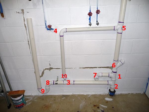

    The picture below assumes all venting above fitting #5.
    It is alway convenient to have a laundry tub near the washer. If you have a plumber do the work I would want a lundry tub and the washer standpipe. But to each his own.
    A picture of your current setup(drain) may help.

    FWIW, the stand pipe on that picture is longer than code allows.
    Oct 2011
    252
    Are you sure about that??
    21,401
    Quote Originally Posted by Hammerlane View Post
    Assuming those are standard blocks, it's over the 30" allowed. Many cinder blocks are 8" tall, then add the mortar - it's over 4 blocks tall. A proper revent has to be at least 42", and it's higher than that and not that far off the floor.
