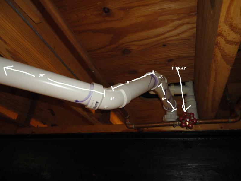

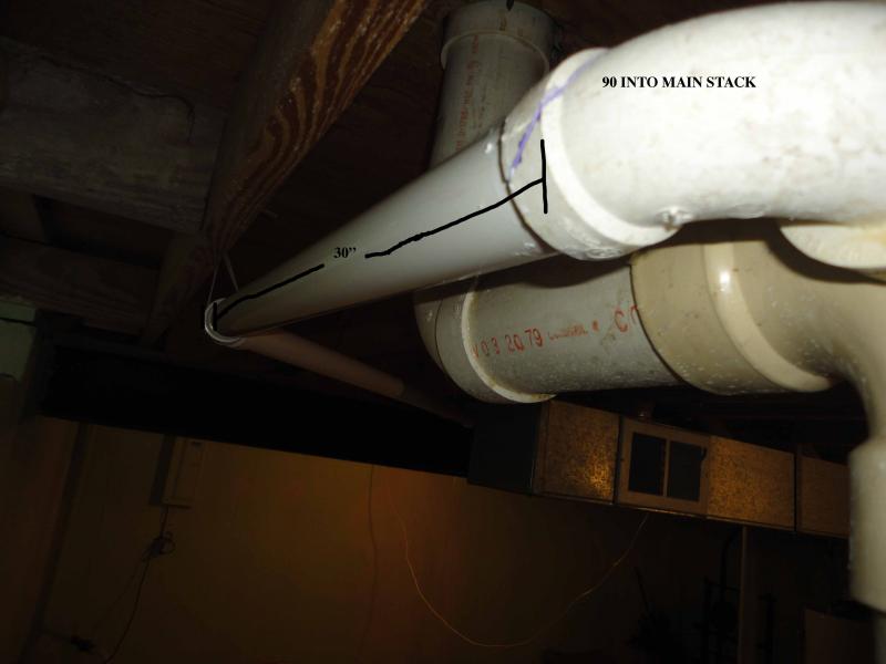

    To make a long story short; I have a slow draining tub. It has been this way since I bought the house. It is a ranch built in '78. I plunged, and snaked the drain with little success. It was still slow draining but not as bad. A few weeks later it was right back to where it began. I got fed up yesterday and replaced all of the 1 1/2" pvc from the stack to the p-trap, only to find that the old was not clogged. I realize while replacing the old drain, that there are an awful lot of turns and it is a bit of a long run to the main stack. Now I'm wondering if this is a venting issue. I could use some advice. If it is a vent issue, are there any easy fixes? Or do I need to run a vent stack up to the attic and then 45 it to the main vent, or make a new one through the roof?

    That tub drain is not vented.
    The vent should come off a the same level as the p-trap.
    Not that the draining would improve if you do, but you would stand less chance of siphoning the trap when the tub drained.

    Thanks for confirming Terry. A few questions; 1 1/2" or 2" on the vent? Can I use a T, or should I use a combo(Can I get an 1 1/2" x 1 1/2" x 2" combo?)? Can I angle it back to the main vent once I reach my attic, or should I just make a separate vent through the roof?
    14,201
    For a tub,
    2" on the waste
    1.5" on the vent
    Most tubs are run with 1.5" traps and trap arms.
    It would make more sense to 45 the pipe below the waste and overflow into a p-trap, if that allows you to vent the trap arm properly.
    You are only allowed 1/4" drop per foot on the trap arm, with max distance to the vent being
    1.5" trap arm, 42"
    2.0 trap arm, 60"
    For instance, the drop on the 42" trap arm would be 7/8" at the max and 1-1/4" max on the 2.0"

    Thank you for the advice Terry! However, what do you mean "45 the pipe below the waste and overflow into a p-trap"? Are you saying to 45 past that beam from the tub, then into the p-trap?
