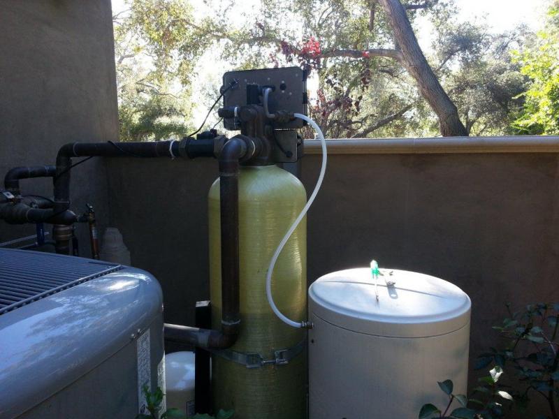

    I have meter from fleck 2" plastic meter paddle with electronic sensor
    I had 3/4" PVC drain line and was taken out yesterday as I saw your post that suggest to reduce some L (90 degree) and plan to change to 1" using long elbow from Conduit PVC Pipe in order avoid sharp turn.
    and the hammering from cycle change I have installed water hammer arrestor 1" about and the location is about 6ft before the system it seems doesn't work and I tried to change with expansion tank what do you think ?
    and just found out that that there is marker writing from my supplier at DFLC fitting 5.0 and 2.0 from BFLC .
    attached is the picture of my system
    thank you again
    Jan 2012
    1,101
    Unfortunately, that meter does not accept any modifications that I am aware of for making it accurate at lower flow rates. The brass version of that meter has an internal sleeve available that makes its low flow accuracy much better. The company that sold it should have considered a slightly different design to accomodate code and your actual needs. You could use the Clack 2" Stainless meter, but that only gets you down to 1.5 GPM for accuracy. Your only other option now is to use a smaller meter. If it were me, I would use the Fleck 1-1/2" inline turbine meter (used on the 2850SXT and 9500SXT). It uses the same turbine as the 7000, and while its specs may not look very good on paper, in the field it is highly accurate at low flows. Technically you may not be to code, but in all reality, it will work fine. It can flow 40 GPM easily. 61560 plus the correct adapters, available with threaded of sweat connectors. You will also need the correct meter cable. Name:  meter.jpg
    As to the water hammer, I am at a loss assuming your plumbing is correct, the flow rate of 5 GPM to the drain should not cause a significant hammer, but... what is your water pressure?

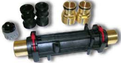

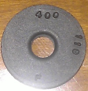

    I'm glad you the expert tell me step by step to check my system, I have yellow color nozzle and I think right now I'm in doubt with outside marking 5.0 on my DFLC Fitting that I told you earlier.
    I took out that fitting and look inside the black rubber button there are number on it (really small need magnifier to read it) . if I can read correctly
    at 12 o'clock is 5 0 0
    at 3 o'clock is 4g or 49 (not clear)
    at 6 o'clock is F
    is this nozzle create the noise sinceI have pressure push to the small button which is not attached tightly to the fitting so create vibration?
    I did think about the Dual system at first time but really don't have space at all.
    Thank you again.
    Jan 2012
    1,101

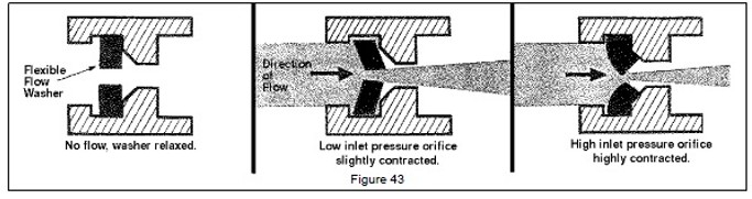

    That would be a 5.0 gpm DLFC. You can safely reduce that to a 4.0 GPM DLFC. Name:  button.jpg
Size:  25.7 KBName:  Unsaved Project Large e-mail view.jpg
Size:  43.0 KB Someone in an earlier post had asked about pressure vs. flow rate on the DLFC, here is an old diagram showing how they work under different pressures.
    You have a yellow 1700 injector assembly. It should be a 1600. The 1700 is typically used on 16" and larger tanks. Replacing the injector requires the brine valve and the injector assembly to both be replaced, and you would need to convert the brine tube at some point to 3/8". Sizing the injector requires all sorts of calculations etc, but it is usually simplified by using a chart. I would recommend a blue 1600 series injector for your application. Here is a link to the manual for more information.
    http://www.pentairwatertreatment.com...al%2041689.pdf
    Hope this helps.

    The DLFC needs to accomodate different pressures and flow at the same rate. The diagram shows how higher presures will cause the button to throttle down the water, thus causing a similar flow rate regardless of pressure. The only way a solid drilled flow control works is if the pressure is known and is constant. The "boom" sound after drine refill is because of the BLFC (Brine line floe control). It is a spring loaded valve that shuts off suddenly, and with it being a 1700 series with a 2.0 GPM flow control button inside (the same style of button that is used in the DLFC), this sudden and nearly instant shut off of a flow of 2 gpm can be somewhat violent. I would recommend converting the system to a 1600 series brine sysstem, and adjust the flow for a 10-15 minute brine draw using the charts provided in the manual for your application. The maximum refill rate of the 1600 series is 1 gpm, but you can use a .5, .25, or even a .125 DLFC button. 1 GPM is the normal and most common size for the 1600 series brine system. (Actually, I prefer the 1650 series, it is an all plastic brine system instead of the brass version, slightly less expensive, lasts longer).
    The total flow during the brine draw is the amount of water the system can push through the injector, plus the amount of water it draws from the brine tank. This decreases to only the amount of water pushed through the injector once the brine tank water is gone, this is why the cycle is technically called "brine and slow rinse". It is two cycles in one.
