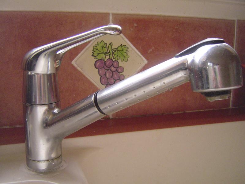

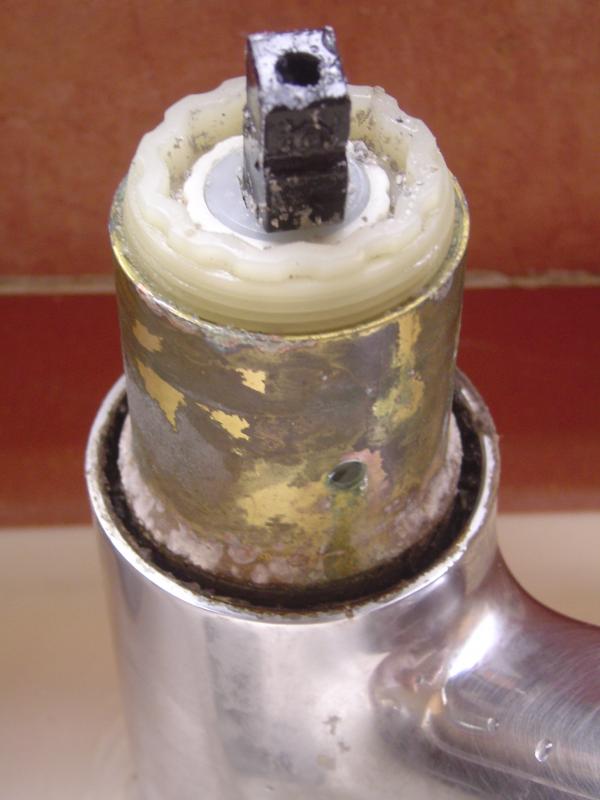

    I have a PricePfister kitchen faucet installed by the builder during fall of 2001. The faucet is leaking onto sink top from base of faucet. Also, water is leaking into the cupboard below .

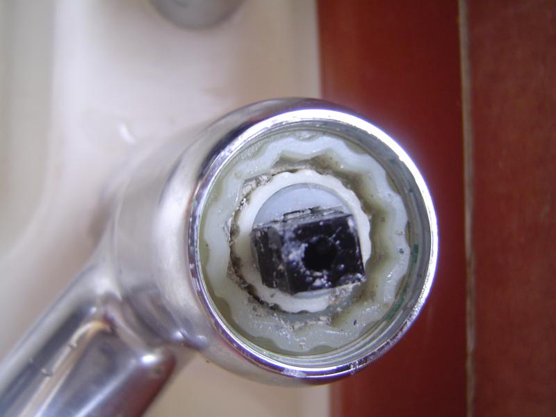

    I am not sure of the exact model #.Attached are some pics of the unit. Please let me know the model # and also advise how to stop the leak. Is it a problem with the cartridge? Also, I see that the retainer ring holding the cartridge is made of plastic and how do I remove the retainer ring?
    Any help appreciated

    http://s7d1.scene7.com/is/content/Pfister/ex-538-01
    this may help. just use pliers gently to remove the white ring. due to failure of the finish in places, consider just replacing this faucet with a new one

    Yes with a 10 year old pfister faucet time to replace, that is why they are made cheap!

    Call 1-800-PFAUCET and send them a picture of the faucet showing the deterioration and they should send you a new faucet. It worked for me.

    Based on the parts break down I will need the cartridge Part # 974-035 and the retainer nut 941-711. It appears the plastic nut # 931-900 has now been replaced with brass nut Part # 941-711. I have searched local Home depot, Lowes and Ace hardware for the above parts with no luck. I am not able to find both parts from the same source over the internet. Most of the sources have the cartridge but not the nut. PF has both, but quotes an arm and a leg for shipping only. Any suggestion? Thanks

    Show Pfister a picture of the deteriorated finish. Shipping for a new faucet will be the same as for the parts, about $9.00.
