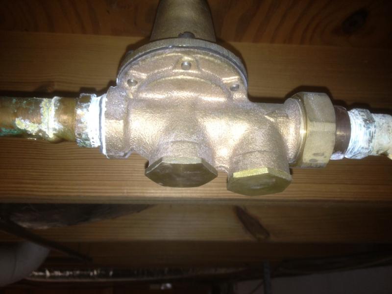

    ok, still no leaking, but the pressure keeps creeping up to almost 90. obviously, the PRV needs replacing. Here is a pic of the current PRV. How do i go about removing it? Do I, first loosen the union nut? Never dealt with union joints before. thanks for your help.

    Yes, loosen the union nut first - and make sure you apply a wrench to the flats on the left side of the PRV when you do so. Once the union is unscrewed, you can turn the PRV off the male fitting on the left (and again make sure you "hold back" with a 2nd wrench to prevent damage to the copper pipe).

    In the majority of cases, you will also have to replace the union because they are not a "standard" size.

    As long as the new PRV is the same length as the old or if there is slack in the pipe(s) this should not be a difficult job. As HJ suggests, the union may not be the same, so you would have to get a new union. I assume the white smears on the screwed connections is pipe dope. Use new dope on the threaded connections, but not on the union.
