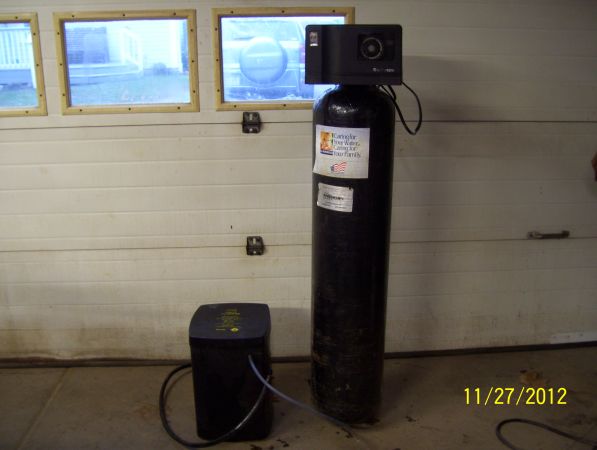

    Well after considering all you guys great input I think I should just wait and pass on this device. After 25 yrs. here I think I finally am realizing a good setup..haha! A metered backflushing sediment only device "which I do need" then "maybe" an iron neutralizer to address that greenish crud that forms on pipes(only up till hotwater tank inlet-after that..seems fine) then maybe a taste filter. seems with all that stuff, I'll be fighting low psi throughout house?
    I saw this on CL..Ionics FA timer-controlled fully automatic fiberglass Water Treatment System. Removes iron, chlorine taste and odor, acid neutralizer, sediment filter. Uses potassium permanganate in small tank. No longer needed as we are now on city water $100.00. but I should prolly stay away from a "do-all system" and who knows how old it is or what it "might" need?
