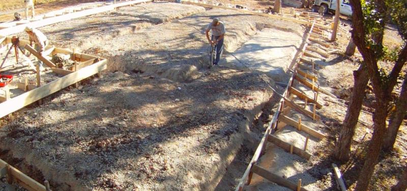

    This is Tuesday evening and the concrete trucks roll on Thursday: guys I need help!
    I have a trench to my new storage barn foundation, and today the builder was helping me with some service items: A 2" conduit for electric, a 3/4" for telephone, and a 1" PVC pipe for water. We were laying them in a convenient beam/trench/footing. He said "you know, PVC doesn't meet code for water, it can crack & leak under the pressure of the concrete" so I pulled it out. But I really need to get water into the same area in order to take advantage of my trench which is at the front of the building, and I wanted to have a hose bib on the opposite side of the building which would be VERY difficult to get to otherwise (rocky soil, long story).
    So how to bring a water pipe into the same area with the other 2 conduits? Maybe PEX tubing poked-thru a 1 1/4" PVC pipe with a sweet 90 elbow (to protect the PEX) or something? Or just go with the PVC Sch40 pipe, but put a thick layer of sand over these conduits (they only extend 8' in before stubbing-out). I really don't want, as I said in the FRONT of the building, to bring the water pipe out of the trench on the outside of the wall and then pipe thru the walls to get to the backside (about 20' away). Note I'm in So Texas so no such thing as a frost line, though a pipe exposed to air can of course freeze down here several days of the winter.
    There must be an approved way to move water thru a concrete slab???
    Here's a pic showing me in the middle fiddling with tape on the current stub-outs and the trench coming-in from the right. Where the guy with the board and the Hilti leveler is on the left is where I'd wanted the hose bib. I'm happy to run pipes in the walls, but would at least like to get to where the other stub-outs are... thanks for any tips.

    You can bring PEX through, and I would put foam insulation around it. That prevents the concrete from touching the pipe and allows for expansion and contraction.
    I've looped plenty of soft copper under and through slabs too, Same thing about protecting the pipe from coming in contact with the concrete.
    25,655
    I ALWAYS loop a copper line through the concrete with a plastic sleeve around it. PVC IS approved outside up to the building, but NEVER inside the building, and definitely NOT under concrete, because you would have to use fittings to make the turn and they could crack.

    As of a few years ago (six or seven), a little farther north in Texas, they used rolled soft copper (type K). Any decent building supply house should know what you want if you tell them what you are doing...
    You don't want it directly touching the rebar for sure -- ditto on the plastic sleeve or foam.
    Be careful where plastic meets copper. Female plastic thread split open and male threads can break off. But, that's a discussion that can happen after the concrete goes in!

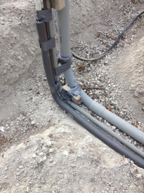

    The deed is done. I also bought a metal 90deg "helper" ell for the 3/4" PEX and the insulation still slipped-over it just fine.
    The Home Depot guy confirmed this was a "normal" way to go, for whatever that's worth. He was sorta cranky; I dunno if it was the early 7am hour, or maybe he was Canadian...!
