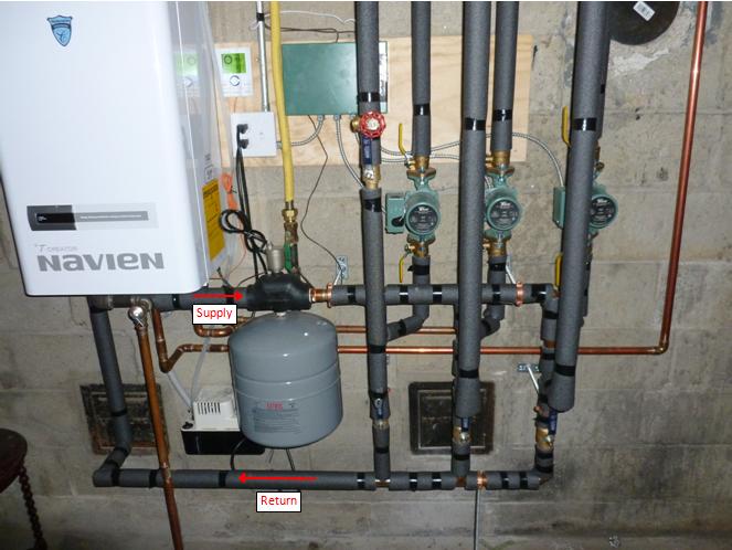

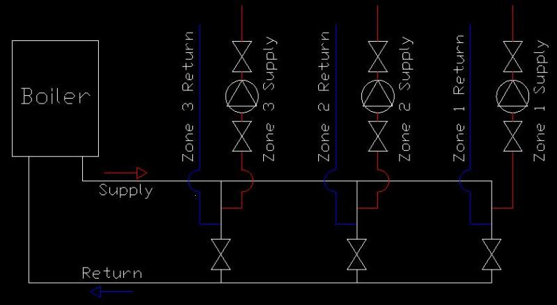

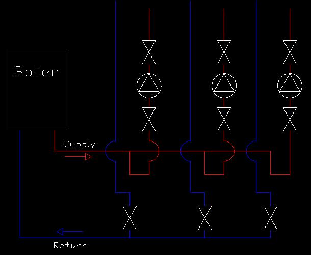

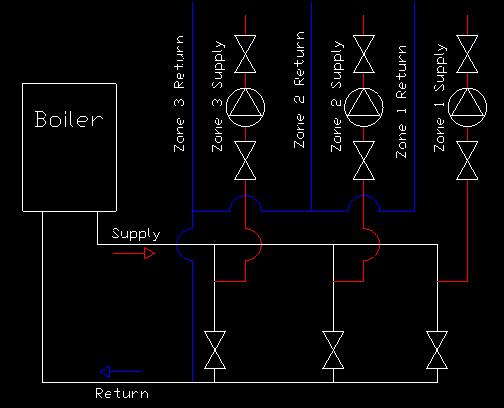

Just out of curiosity what is the supply side what is the return side. Is the supply side supplying water to the boiler or supplying water to the system/radiators. Same with the return side, is it returning water to the boiler or returning water to the radiators/system. Trying to understand if my circulator is on the return side or supply side. Same with the expansion tank - supply side or return side.
