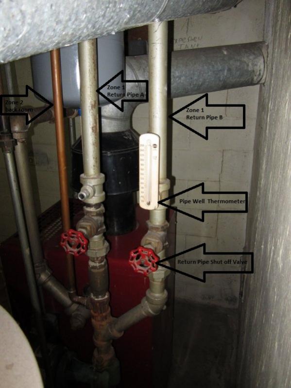

    This is on a separate area then we've been discussing but since I'm becoming a pro on my boiler thanks to everyones help I'm curious about this. Zone 1 which is the whole house starts off as 1 main pipe and then breaks off into 2. One covers I believe the front radiators of the house and the other the back. Then the two pipes return right before the boiler where they are merged into one. Each pipe about 3 feet above where it comes back into the boiler has a thermometer. Old school mercury thermometers then stick into a well that goes into the pipe. I think there is graphite in the well to help transfer the heat to get an accurate reading. Anyway one pipe is always cooler than the other. For example right now the temperature at the boiler is 160-162. The temp of one pipe is 144 the other is 154. I remember Dana saying that I'd have to be careful that theres not air still in the system after draining it? Could this be an issue. Or is just one pipe have better circulation than the other so its get more of the hot water quicker?
    thanks jay.

    It could be several things that I can think of (and I'm sure others I can't): the total length of one branch and the radiators on it is longer and has more square feet of radiators on it, or, the flow isn't balanced, or one side of the house is colder than the other (say the windier side?). If it is a balance thing, you'd need to add valves in each line to help balance each. You might also want to swap the thermometers to verify you get the same results. It might just be that the heat transfer material isn't providing a good transfer, and the water is returning at the same temp. If the radiators have shutoff valves, make sure they are all open the same amount (normally, fully opened).

    The different return branches would likely not be exactly equal temperatures. The lower-temp branch probably has more radiator length on the loop than the warmer one:
    more radiator = more heat extracted from the water = lower return temp
    Since they mix before entering the boiler, the water entering the boiler will be at some intermediate temp. Anything over ~130F is fine for the boiler, but for a terra-cotta lined flue you'd want to be a bit warmer than that. If the system always comes up to the 144-154F return water temps on every burn you have plenty of margin. When the system hasn't fired for awhile it'll take several minutes before it gets up to temp, but that's fine. It would be an issue if the thermostat(s) were usually satisfied before reaching that temp, and it was chronically running with return water temps in the 120s or lower.
    If there's air in the system there are potential flow issues, but if all radiators are getting warm you have enough flow. With vents at the top of the system any remaining air will eventually find it's way out, long as there is flow on both loops.
    Are they true zones, with separate thermostat controls, or is this just a branch? If the latter, there's a good chance that the system has valves to throttle back flow on one or both branches as a means of balancing room temperature differences. (If you constrict flow on one it forces more flow into the other.)

    Dana- they are branches. I have 2 Zones but one is a separate back room/enclose sunroom that was added later with copper pipe and slant fin baseboard. The main zone with the 2 branches do have shut off valves right below where the return pipe thermometers are. I could close one and restrict its flow a little to get the temperature to match up better. Pics below

    It doesn't much matter if the return water branches match. The valves are there for getting the room temps reasonably matched & comfortable on both branches. Gate valves like that see excessive wear when used for adjusting flow (ball valves do much better), and may not seal completely after years of use in a half-way position. If you're happy with the room-to-room temperatures, just leave them alone. Tweaking them will have no effect on the temperature the boiler actually sees.
    If you're seeing 9psi in the basement it may start to suck in air at the top of the system, depending on just what the elevation difference is between the top of the system and the pressure gauge.
