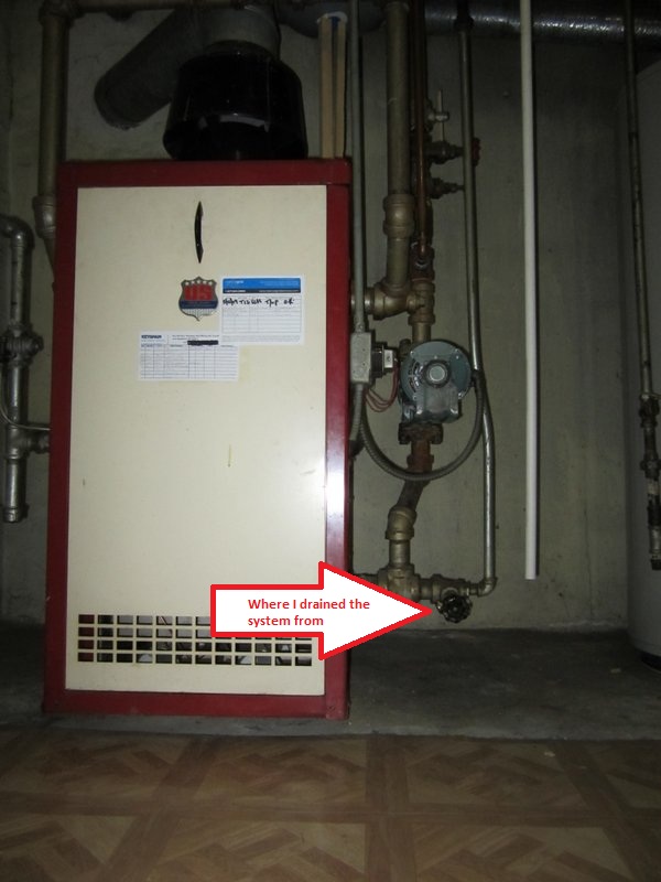

    Jumped the gun Dana. I drained the system to find out exactly how many gallons it held. Hopefully it wasn't too bad for the system. I started draining it at 12psi. 47.5 gallons came out. The first 2.5 gallons brought it down to 0psi. So I'm not sure if its considered 45 gallons or 47.5.
    There are 2 temperature gauges. Inside the boiler - which never goes below 95 and i've seen as high as 170. Then there is a thermometer on a return pipe. I've never really paid attention to that temp. The room is usually between 60 and 70 degreees.
    Is the 30 enough and do i have some other problem or should a 60 be on it?

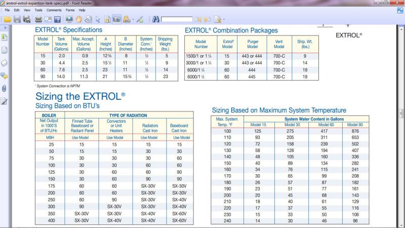

    I played around with the Watts calculator. Temperature doesn't change it that much, even if I use room temp as the lowest setting not aquastat temp. But moving that pressure release valve number from 30 (which is what I entered) down to 20 really makes it bigger. Also the drain is all the way on the bottom of the boiler (included pic). Not sure how much more water was left in the actual system. Good news is there is now a Amtrol Extrol Model 60 on there along with an Auto Air vent on the branch of piping going to the expansion tank.
    The figures for the Extrol Model 60 are 7.6/2.5. Also from this site ( http://www.pexuniverse.com/docs/pdf/...tank-specs.pdf ) they tell you what model Extrol should be used depending on BTUs and based on Max temp. I've including a screen shot of those charts below. My system matches up well with the model I have now.
    I'm going to reread the second part of your reply to fully comprehend it since you are spot on with a lot of it
