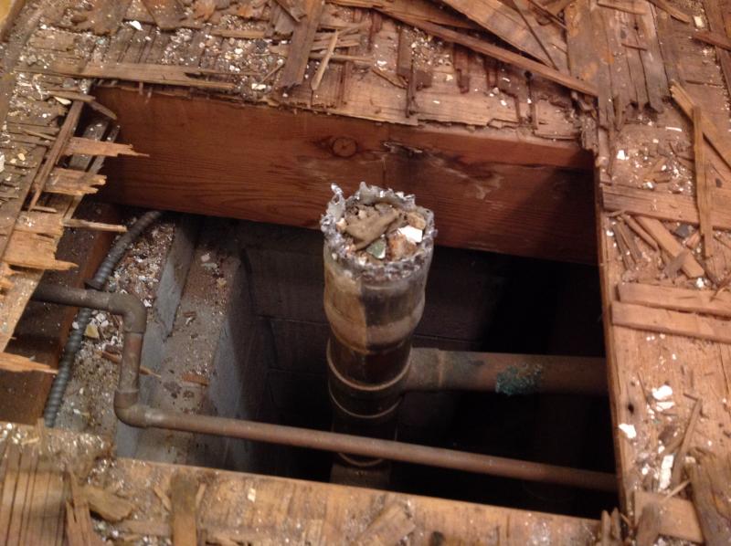

    I'm renovating a powder room. The biggest part of the job is removing and replacing the tile floor / sub-floor. This also means I had to remove the toilet flange. In the process of removing the flange I damaged the drain pipe. Not sure it could be avoided as it is pretty soft; lead I guess. In any case, I will need to repair this. What is the proper approach.
    Louis
    19,234
    It looks like you have a long enough stub of copper coming out of the fitting below where the lead was installed to just cut off the leaded section with just clean pipe sticking up. THen, I'd install a no-hub connector (you'll probably have to go to a plumbing store to get the right sized one) and build it back up with pvc or abs (whichever is typically used in your area). THe only reason to keep it all metal would be if it were required, which probably isn't the case (it can be a requirement on high-rises and in some union friendly locations). Keep in mind that the proper location of the toilet flange is on top of the finished floor and anchored through it into the subflooring. If you notch the tile before laying them, you shouldn't need to drill through the tile. THe flange should be tight on top of the finished floor with the rim supported by the finished floor (which means it must go under it).

    Jim,
    Thanks for your help.
    Where does the copper end and the lead start? Is it at the bulge? Above or below. Any recommendations on the "no-hub connector"? There seem to be a lot of choices.
    I know to put the flange over the tile. I doubt that pre-drilling the tile will work well since it is the rather complicated small mosaic stone my wife bought. :-/
    Thanks again for your help.
    Louis
    19,234
    Look at the copper coming out of the fitting below where the lead is attached...cut below the bulge where the lead is - it should be the same diameter of the pipe coming out of the fitting below it. You need maybe 1.5" or so sticking out. A no-hub connector is a rubber sleeve with a metal reinforcement ring around it that is then clamped to the pipe with SS worm clamps. You'll need one designed for copper on one end and plastic on the other - those sold at places like Lowes or Home Depot generally are used to connect plastic to plastic or CI to CI, not transition. A plumbing supply house will have them.

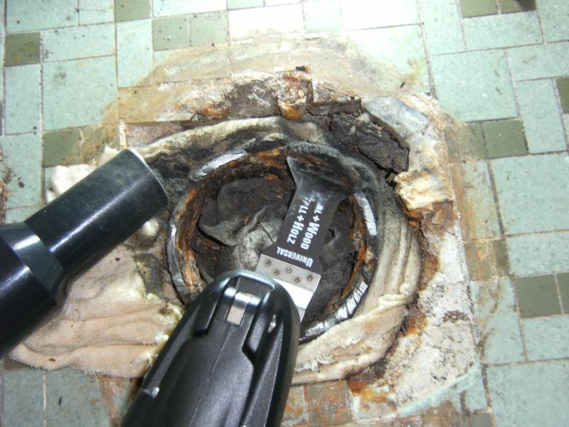

    You've got lots room for maybe a SawsAll, etc. but in my case, I used a Fein Multimaster below. I tried a Dremel but kept on breaking the discs.
    That jagged pipe was from the original build in 1956.

    With the advice I received here I was able to cut this down to the copper with a clean and straight cut. I ended up using my IR cutoff tool for a rough cut and then finished off with my Dremel tool using a large screw clamp as a straight edge. Worked perfectly.
    I got a Fernco Proflex coupling from the local plumbing store. I went in looking for a 3007-33 for a 3" PVC to copper but they didn't carry it. Instead I left with a 3001-33, which fits but is specified for CI to PVC.
    Will this be okay or should I find a 3007-33? Once this is installed, getting to it will be near impossible.
