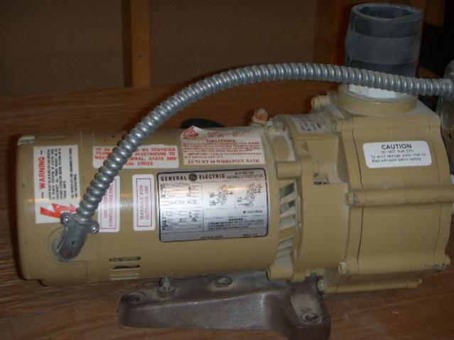

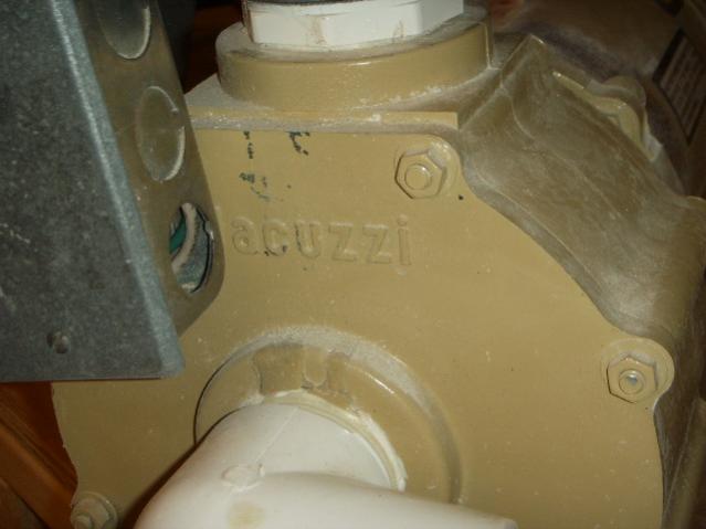

    Default Jacuzzi motor
    [QUOTE=sdmarkus;362974]Howdy All,
    My plumber has offered me a free whirlpool bath for our master bed/bath project. Only problem is the pump is missing and there is at least one pvc line that will need to be replaced.
    if you are still looking for a jacuzzi motor I might have one for you. I pulled out my "Pearl Whirlpool" to install a walk-in shower which I am still working on. Moving the motor out of my way today I realized it is a Jacuzzi motor which was on a non-jacuzzi whirlpool. Model number 1 UPC-S. you can have the motor if you want it. Just check with your contractor to make sure it will work on the Jacuzzi you have. Photos below
