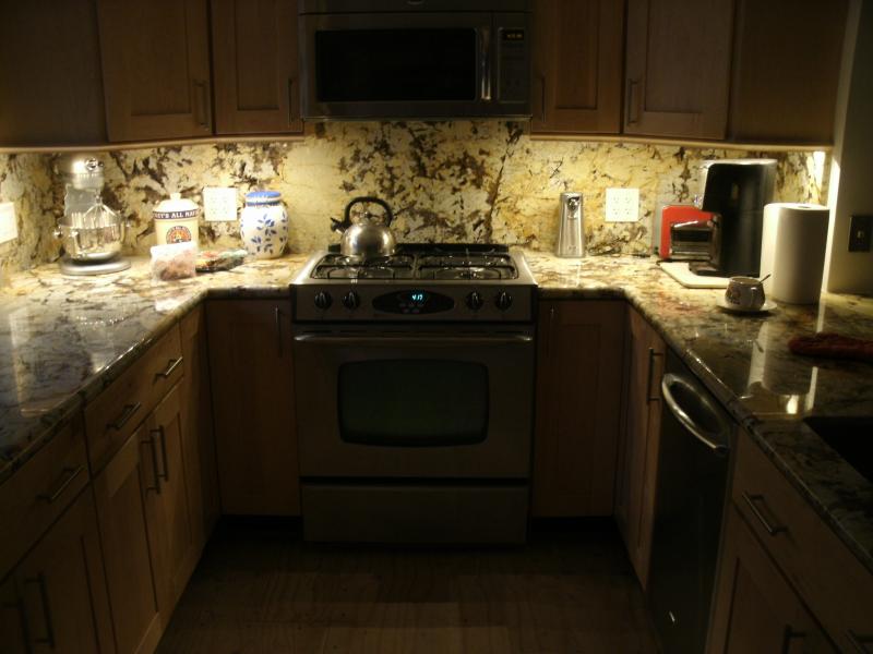

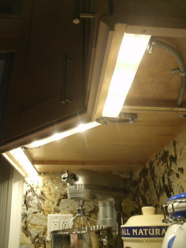

    IBEW Electrician big2bird's Avatar
    Sep 2012
    Anaheim, Ca.
    141
Size:  50.4 KBName:  counterdone 049.jpg

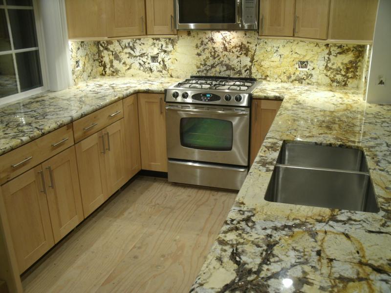

    Sep 2012
    Anaheim, Ca.
    141
    My entire kitchen, including the recessed cans are L.E.D. If all the lights are on, it draws 80 watts. Laundry is 16 watts. Bathroom is 30 watts. I hate high electric bills.
    Sep 2012
    Anaheim, Ca.
    141
    Quote Originally Posted by Homeownerinburb View Post
    Looks like they are really effective.
    Like the marble.
    Thank you. It's called "Kodiak" granite, quarried in Brazil. Kinda busy, but really looks great in person.
