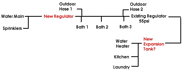

    Hmmm... I don't think I asked my questions very well... so let me try again.
    Here is a rough schematic of my COLD WATER LINE:
    The items in black are existing items,
    The items in red would be new installations.
    My questions are:
    • Can I have two regulators in-line? One with higher pressure - 65psi, maybe, and the existing with 55psi.
    • Do I really need the expansion tank - I haven't had it since I moved in 5 years ago.
    • Are any of the attached shark bite regulators (in my first post) adequate for regulating my entire house?
    • Should I reuse my existing regulator and put it in the new regulator location and install the expansion tank where the exiting regulator is at?
    • Why shouldn't I have a regulator on my garden hoses?
    • Does my measured pressure at my garden hoses (95psi) seem like excessive pressure?
    Thanks,
    Tindel

    Code requires in-house water pressure to be limited to 80psi...an inspector when it came time to sell might give you grief, and some valves do not work well at that pressure. Many people like to place the PRV after the takeoff to the outside hose bibs - it does make watering the lawn easier (it's still against code if the pressure is over 80psi).
    A PRV makes the system 'closed', and that means that when you replace heated water in the WH with cold, then it gets heated, it will expand. It cannot leak back into the main line because (if the PRV is working right anyway), it's a one-way valve, so it must leak out somewhere. You might find that that's happening slowly in a toilet, or some other place, but if they all are working really well, the pressure will rise enough where you'll get a release from the T&P valve on the WH. This valve opens at 150psi, and that is easy to attain in a closed system when you heat water. So, starting with high pressure then heating water, you're putting lots of stress on things. This increases the likelyhood as the faucet hoses age along with the washing machine and maybe icemaker supply lines will blow out. You really don't want to risk it. If you have pex water lines, they are actually absorbing the expansion by bulging. It's not a great scenario...a closed system must have a means for expansion, and that's an engineered expansion tank.
    Yakima WA
    6,889
    One PRV is enough. Set it at 60 psi and your good to go, but do heed our warnings about the expansion tank. Have you a back flow prevention device in the irrigation side? They required although some places do not enforce the law on them. Not only should there be one, but it should be certified annually by a certified inspector.

    Well - I moved my PRV to supply the entire house. I also installed an expansion tank. Both are set to 55psi. My toilet valves seem to be much happier. I haven't noticed any water hammer in the last hour since I fixed it anyway.
    Gary - I'm 99% sure that there's a check valve on the sprinklers. It's a pretty bulky system.
