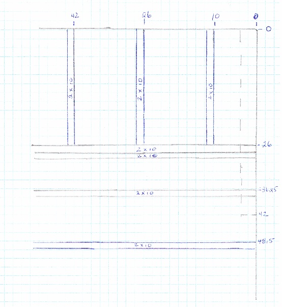

Here's my joist layout dwg after a bit of cutting out of the floor. Hopefully it shows up ok. Ensuite Joists_0001.jpg
Now let me explain:
1. The top horizontal line is the inside of the wall framing on the external wall.
2. The far right vertical line is the inside of the wall framing on the external wall.
3. The dashed line indicates a wall I will be adding to run the plumbing so that it is inside the insulation.
4. All the joist are 2" x 10".
5. Horizontal dimensions are (from right to left): 0,10,26,42 inches
6. Vertical dimension are (from top to bottom): 0, 26, 36.25,42,48.5 inches

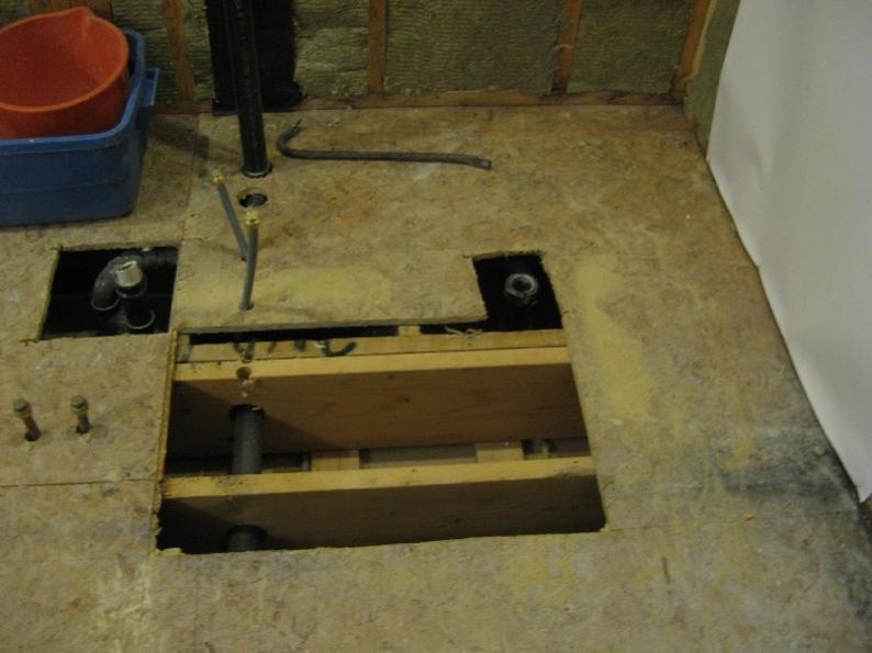

Also, here is a snapshot of how it currently looks:

FWIW, most of the strength in a solid joist is established by an intact top and bottom section - one in tension, the other in compression. The rules for drilling holes restrict cutting holes near the ends since that's where walls and things may be located and pose a crush risk. Other than that, the holes need leave the top and bottom of the joist intact. Think I-beam or truss...the top and bottom are important, while on some designs, the middle is mostly open. Basically, the middle holds the top and bottom in the right place in a beam, but may not contribute a lot to the overall strength. That's why there are restrictions on where you can drill holes. The further apart the top and bottom are, the stronger it gets (if you can keep the top and bottom aligned).

Hi Freddie.
I personally hate working over OSB sheathing like you have there. Any chance you plan on switching it out for regular sheathing?
I have to take up at least 1/2 of the floor for mods to plumbing drains and water supply to freestanding tub so I was planning on changing it. What do you mean by regular sheathing? Plywood? Our whole house is OSB. What is your concern here?
Where the floor joists meet each other (IE North South meets West East) are those joist tied in to each other with a Simpson Strong Tie joist hanger? I can not see the nailing pattern on how these where ganged together. Are they nailed together from the other side. Stacks of 4 nails (3") on about 8-10" centres????
Looks like 3" nails in stacks of 2 every 16", no joist hangers.
Any idea why the sub floor is going black in the bottom right corner? I would open up the drywall and inspect that wall a little near that area.
Black is small surface mold from front corner of old shower base. I will be taking that up and replacing once I prepare for plumbing changes. Want to do all the flooring at the same time. Also there are some parts around the toilet that need replacing as well. So basically I'll but removing all of the floor by the end of it.
Is the linear drain going at the entry at roughly 42" off that back wall? If so then it's not so hard to recess that space as long as there is no HVAC, wiring, and plumbing in that bay.
Yes. Space has no HVAC, wiring, some water supply to toilet but that is a 1/2" line that runs below the joists; between the bottom of joist and ceiling drywall of 1st floor. The drain plumbing is a bit in the way and most likely will have to be moved. I have to up to 2" anyways so... It comes through the space currently parallel at 37" from the right wall.
Tha black ABS pipe appears to be rubbing the floor joists. How large of holes are drilled here? Make sure no holes are drilled within 2" of the joist top or bottom. That means the edge of the hole not it's center so a 2 3/8" hole drilled in a floor joist needs to be started no closer than 3 3/16" from the top or bottom...
Holes are just a bit bigger than the current 1.5" drain and are 3 1/4" from the top fo the 2 x 10. No rubbing.
Did talk to the city inspector by phone and as you said, no code with respect to curb or no curb, they don't even turn on the water. All they do is make sure plumbing changes were done to code and are inspected before flooring and walls put back on. No flood test but I be doing it anyways. Mostly concerned that proper waterproofing is done. 6' up in shower, 16" above tub with no hand spray, 3' - 11" with hand spray in tub. Water resistant floor outside of tub. Basically Ceramic tile is considered waterproof even with the grout. He said that most backing used is waterproof anyways. I guess he assumes no one will tile on drywall or greenboard in the shower without Kerdi or roll on waterproofing but that's a big assumption for those not doing the research.
