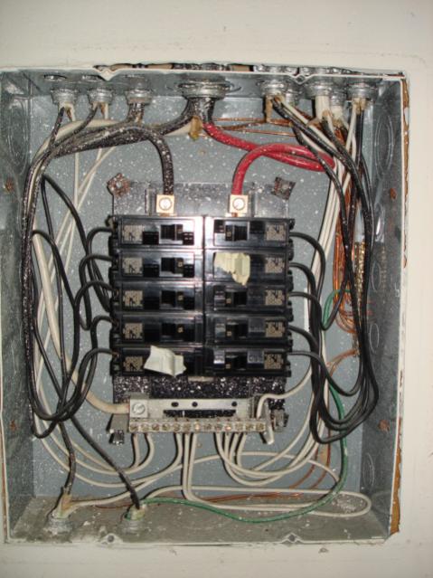

Just to be safe I cut the power at both the outdoor main panel and the indoor subpanel before removing the subpanel cover
I can see the bare grounding conductors fastened to the ground bar on the right, and the white neutrals all connected to the neutral bar on the bottom. The grounds and neutrals are not connected together in the subpanel, but my understanding is they are bonded together at the outdoor main panel. I don't understand why the cable coming in at the bottom has a green conductor instead of a bare wire, but maybe just what they had on hand?
This may be goofy but just to satisfy myself, I connected a 25 foot length of zipcord to the ground rod outdoors by the main panel, and brought the other end inside to the unconnected bathroom fixture wiring. I get 1.2 ohms resistance from the bare gounding conductor to the ground rod, and 1.3 ohms from the neutral to the rod; the zipcord reads 1 ohm by itself.
I'm thinking the main wiring for the panels out to the transformer is correct but if I'm misinterpreting something, please let me know. Because of the issues I've seen, I'm planning to check all of the fixture wiring connections; apparently they used hacks for that.

Your measurement sounds about correct.
There is nothing wrong with Green.
The wire just cost more, in most cases.
The Ground does not have to be Bare.
You don’t have to run a wire all the way out to the ground rod to take a measurement. All you need to do if read the continuity of the green or bare and the white in the fixture.
In the service equipment the neutral (white), the equipment grounding (green or bare), the metal enclosure, and the ground rod will bond together so there is no need for the zip cord all the way back to the rod.
The path that you were reading was from the meter through the zip cord to the rod up the grounding electrode conductor to the neutral in the service back down the neutral to the meter.

Yeah, I kind of figured that. I did first verify continuity between the bare grounding and neutral conductors at the fixture as DonL suggested. I think I just got paranoid after finding so many fixture grounding wires hanging loose that I was afraid maybe they could have left things hanging loose in the main panel. In my simple mind I thought I was just making sure everything was properly bonded to the rod and really at earth ground.
I just can't get my brain around the principles of ground vs neutral in building wiring. I don't understand, if they both have the exact same continuous path back to each other and to earth ground, and apparently even back to the power company, what purpose the additional bare conductor has. Why do we care which of the two "ground" conductors the electrons use; I know this is wrong but to me, it seems like you could just use the neutral for grounding fixture housings and do away with the grounding conductor.

Oversimplified, a nuetral is a current carrying conductor that "happens" to be at ground potential.
A ground conductors sole purpose is to bond all the metal parts, and to carry any fault current.
Even though they are at the same potential, they have differnent distinct "chores."
IF the nuetral was NOT at ground potential, and you looked at it as a hot wire, you would not be confused.
Once a conductor is carrying current, then it becomes a load...meaning it has resistance and Ohm's law kicks in. The voltage at the source of the current will be I x R. A point in the neutral system can conceivably have several volts potential, with respect to earth ground. IF that point were tied to the bare ground wire, then the metal cabinet of your refrigrator, microwave, maybe even your shower head...whatever, would be at that potential...which is potentially dangerous.
All of the current that goes out on the hot must return through the neutral. The ground wire should never be designed to carry current - it is there for protection as a safety backup and, if there were a short, to cause the breaker or fuse to trip. Ground would normally only carry current when there is some soft of fault.
I think that's the part I was missing. With electronic equipment I slipped into the habit of thinking of paths to chassis ground as dead shorts because, except with RF, the very small resistance/impedance can be ignored. So I was thinking of the neutral the same way; ie, if one end of the neutral is at 0 volts (relative to earth) at the panel, then the other end of that big copper wire was at 0 volts, too. Obviously, since the neutral carries current, that's not possible. It's not nice to forget Ohm's Law.
