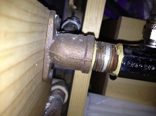

Found a leak under my bathroom sink. I think it is a simple one to fix, but would like some backup as I am a newbie at this.
There was no moisture above the joint pictured (see below). You can see a water drop at the right hand side of a threaded section of pipe by a shutoff valve -- the handle is just out of the frame, but you can see the flexible supply line connection nut. Ignore the tilt of the picture -- it's the best I could do in a tight space.
Anyway, it appears as though this is just a simple threaded joint. I removed the supply line and tried to tighten the (Brass Craft) valve onto the short stub of copper pipe, but I couldn't get it to budge. I was using a super short wrench, and I was kind of nervous to apply too much torque since I don't know what the h*ll I am doing -- it took several minutes for me just to figure out what kind of joint I was looking at. It seems as though I could just:

Replace the galvanized nipple with brass. You have a galvanized nipple between a brass valve and a brass fitting.
John
That is NOT a "copper stub", it is steel nipple. Remove it and replace it with a brass one. I didn't realize there were so many steps to take in order to remove it. We just usually turn off the water, remove the valve, and replace it.
For now, you could remove the line up to the faucet, and turn the valve another 1/2 turn onto the nipple. That might fix your leak.

You can use pliers or pipe wrenches. I do almost everything with pliers. I get a kick out of movies that show plumbers with giant pipe wrenches working on small fittings. sometimes on the wrong side of the fixture, the side with no plumbing.
Brass is permanent. Galvanized steel will close up over time with rust. And placing steel between copper and brass just speeds up that process.

A "close nipple" is the shortest, and some will have flats for applying a wrench between the threaded ends. Wherever possible, it can be best to use a nipple you can tighten into one fitting before attaching the next rather than just putting all three together and tightening both connections from one end. And along with that, using a nipple with some "grip room" in the center can help make it possible to later remove that nipple without damaging its threads.

That shutoff valve looks suspiciously thin where the female pipe threads are supposed to be. I wouldn't trust a valve like that not to split when tightened down.
For sure, I would remove the valve, clean the threads thoroughly, and inspect closely.
You do NOT tighten the nipple into the valve. You apply sealing compoud to both threads then screw it slightly into the elbow, then screw the valve onto the nipple, THEN tighten the valve which will also tighten the nipple into the elbow. Pipe wrench, adjustable "Crescent" wrench, or pliers, whichever you have the strength to use will do the tightening. The nipple you have is 1 1/2" long, also called a "shoulder nipple" and they will have a brass one the same length. Oh, I, and many if not most, plumbers would change the other one at the same time.

You do not really want any steel/iron in your supply lines. You may have used it because you were scared to try to solder things, but there are other choices that are essentially permanent, iron/steel is not. And, eventually when it starts to rust, you'll have rust streams in the sink or wherever that supply runs to.

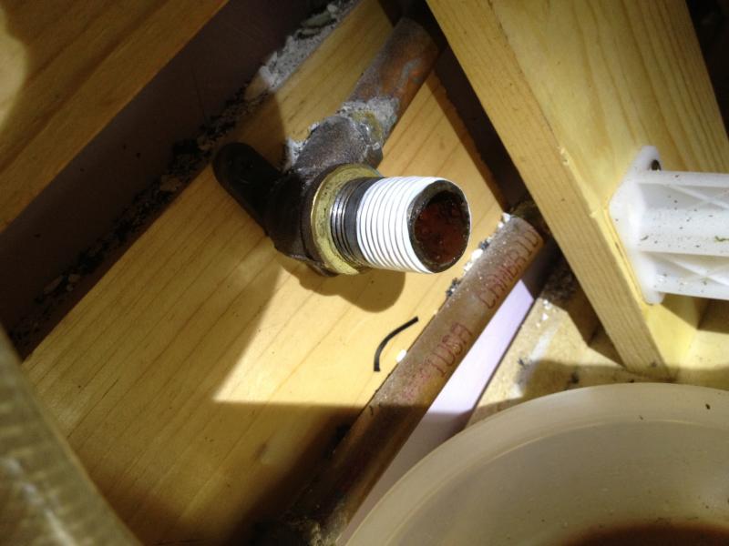

Well, I took the stop off and cleaned the threads of the steel nipple and wrapped them with teflon tape. When I looked in the female threaded end of the stop I saw some debris, which I realized was the end of the nipple that had crumbled. I hadn't noticed when I was cleaning and taping -- or maybe it was "wishful non-seeing" it. I put the stop back on anyway, and the supply line, but it leaks still -- possibly slightly more now. Looks like I have to replace the nipple.![]()
quote; Looks like I have to replace the nipple.
That is what we told you to do from the start, but you may also have to replace the valve. I would NEVER remove one of those valves and then actually reuse it. That would usually be a waste of time.
