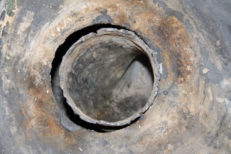

    Hi. I'm hoping somebody has encountered this situation and may have a suggestion.
    The floor in our 2nd floor bath is a mashup. Most is 3/4" plywood, with some concrete sections around the borders. The toilet sits on a slab of some sort of stone -- slate or bluestone perhaps. It does flake. As you can see, the old flange has been removed from the drain pipe, which appears to be made of lead -- it's very soft. The pipe is not centered in the hole that has been cut in the stone, and it cannot be moved.
    The stone slab is about 3/4" thick, and cut on an angle that increases the interior diameter from top to bottom. In other words, if the diameter of the hole on top of the slab is 5 inches, it flares out to a larger interior diameter at the bottom of the slab. It appears to be resting on the floor joists, so there is air underneath it.
    A compression flange that fits around the exterior of the pipe does not appear to be an option. I could chip away enough of the slab so that it could fit around the pipe, but then it has nothing to sit on. My only option seems to be a pvc Sioux Chief flange with a metal reinforcement ring that fits the interior of the pipe and seals with a 3-ring rubber flange.
    I would like to fasten the flange to the stone slab at three points, taking into account the fact that at least one of the fastening points will be close to the edge of the stone, so I need to cut clean holes in the slab, without destroying it. Then I would use toggle bolts to tighten down the flange. (By the way, the floor will be finished with 1/4" backer board and 1/8" ceramic tiles, all secured with modified thinset.)
    Is there a tool that can give me a clean hole through the slab? If not, does anybody have an alternative solution? Thanks in advance.

    If you have a lead closet bend, NO ABS or PVC flange is going to seal to it. This needs to be done right, or you are going to have a leak. Without seeing what is there, it is impossible to say what needs to be done.

    I guess the proper solution would be to extend the drain with some sort of collar and then lead caulk a new brass flange at floor level. Unfortunately, that's beyond my skill level. Here's the unit I plan to install
    http://www.siouxchief.com/Drainage/R...ush-Tite.VZ8US
    The 3-rib gasket fits very snugly; the plastic down pipe can be trimmed to accomodate the bend. And, yes, the diamond tip hole saw looks like a winner. I found one at the local tool rental in 5/8". I'm just hoping the slab does not shatter drilling so close to the edge and that the plastic flange holds up under daily use. I have read posts on the web from others who have used non-metal flanges successfully . . .

    None of the expansion toilet flanges are designed to work in a leaded pipe. The lead is highly unlikely to be nice and round, and getting a proper seal is very unlikely.

    Normally you would have enough lead to work with. You are kind of short there. Like someone broke off what was needed.
    Is there a way you can work from the lower floor, to remove the lead bend and install new pipe?
    The fitting you are thinking of is not designed for use in lead.

    You're right, Terry. I removed the old brass flange because it was damaged on one side and flush on the stone slab. I need to add the backerboard, thinset, and tile. I might have been able to use a flange repair kit, extenders and/or an extra deep wax donut, but that's water under the bridge (or down the drain) at this point.
    I'd like to avoid working from the lower floor, if possible. I could probably remove the slab and work from the top down, but it appears from the link that I would have to cut out the lead bend and install a plastic one. There would be a bit of a learning curve involved. And I'd end up with a plastic toilet flange in the end regardless.
    Are you sure about the flange insert being not compatible with lead? It seems to fit pretty snug and secure in the old pipe.
