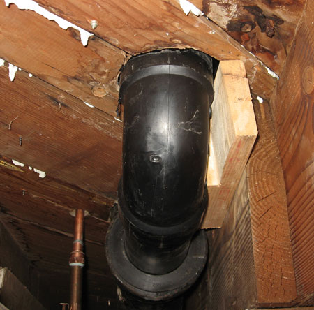

    Here's a lead bend replacement using 3" ABS

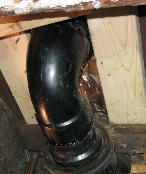

    Here is a closet bend in an old Seattle home, using the 4x3 spigot closet bend and a 4" hub flange.
    And this is the toilet that was installed afterwards.
