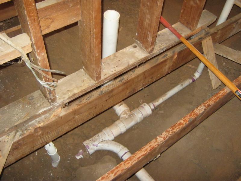

    I did this a year ago and just went back and looked at the pictures. Should I have put a long sweep 90 on the toilet going to the main line? I forgot what my reasoning was at the time but it probably wouldn't have fit and I didn't want to do any more digging...

    What is that 2" elbow in the background? You managed to take the picture precisely so it was obscured. If that is for a tub or shower, then it IS both illegal and will not work. IF you had used a "closet bend" it would have had an even "sharper bend" than your elbow so it is okay, but the sanitary tee it goes into is NOT. Your toilet vent is also NOT according to codes. According to your picture, you have a 2x6 sticking INTO the 2" vertical pipe at the left. How did you do that? as fpr the second part, "Will it work", almost every cockamammy idea DIYers come up with "will work" which is why they want to do it their way. The questions then become "how well will it work and for how long".

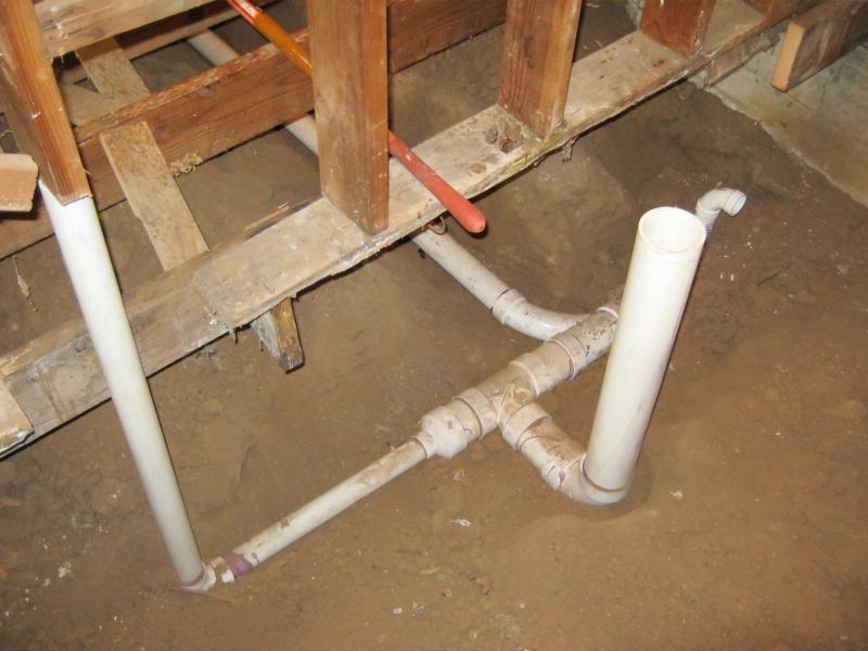

    Here's another picture. That 2 inch elbow in the background comes up from the main drain line and 90s over to a shower drain. The 2x6 is an old wall that got cut out and replaced. The 2 inch vent pipe goes up through the wall. So what's the worst case scenario and how should it be fixed?? Here's another picture.

    The reason I went with the 2 inch vent is because I wanted to make the wall a 2x4 wall. Plumber said it was okay to have the vent pipe 1/2 diameter of the toilet pipe. Probably should have done 3 inch for the toilet, but the existing one was 4 inch so I replaced what was there.
    Just a fellow DIYer here, but I believe you should have used a double-wye where you have that sweep 90, and then a 45 or whatever to get the toilet line over to it. A sanitary tee should never be used horizontally, and the one you have there for the toilet line could be troublesome since solids can stick at the turn and you have no cross-flow to help keep it clear.

    I see your point about the tee. I didn't do my homework before doing that. That would be easy to dig back up. What about that shower drain? It comes up from the main pipe about a foot then 90s over to the bathtub p trap about 4 feet over. Is that going to cause me problems draining? (I haven't used the house yet)

    While I agree that the sanitary tee should not be used on it's side or back, (wye fittings are always used on horizontal) I would be more concerned about the improper/lack of venting. If that is a dry vent, it will be clogged the first time there is the slightest backup. The shower/tub is also not vented. All vents must rise vertically until they are at least 6" above the flood rim of the highest fixture served. I am sorry to tell you that the best thing you could do is cut all of that plumbing out and start over.
    Here is a nice link to Bert Polk's plumbing tips- http://www.co.lincoln.or.us/planning...mbingguide.pdf

    That 2 inch is actually a drain for a sink as well as the vent. Does that make a difference? And what about the tub? The bathtub has that little vent thing on it. I thought that was the vent for the tub.

    The toilet can be wet vented through the lavatory drain, but bend at the bottom of the vertical stack should be a long-turn 90 or a pair of 45s. The connection of the wet vent to the main line should made with a wye which should be downstream of the water closet.
    The tub must have a vent located downstream of the trap. The tub's overflow is not a vent, it is an overflow.

    Okay, did my homework, can't find it. With a 2 inch drain pipe, how far away from the trap can the vent be? It goes from horizontal to vertical after about 2 1/2 to 3 feet away from the trap right now.
    Here's my plan, someone tell me if there is a problem with this. I plan on cutting out the 90 where the tub drain goes from horizontal to vertical and adding a 2x2x1 1/2 fitting, then taking the vent pipe up about a foot, put a 90, and sloping down a little and tying into the 2 inch main vent that goes up to the sink. I'm sure that's not code but I don't want to cut out any sheetrock.

    I think with a 2" pipe, it has to be within 5', so IF I'm correct, that part is okay. BUT, a vent, like a drain must not have a place where moisture could accumulate (i.e., it CANNOT go up/down/up - it must contain a continuous path for moisture to flow should any get into that pipe) plus, code says it must go at least 6" above any other drains in that run OR 42" above the floor, whichever is higher before it can go horizontal. Any rain, snowmelt, condensation, etc. that gets into that pipe where it goes back down for a bit will accumulate, block it off, and make it inoperative. Sometimes, you just have to bite the bullet if you want it done right.
