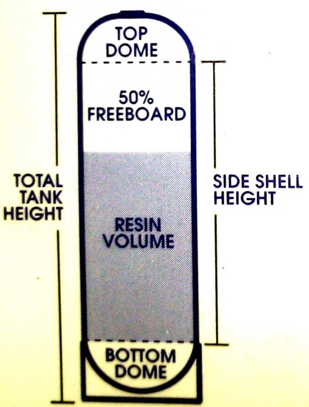

    Newbie here with some questions about a 2 cubic foot Centaur carbon filter I am setting up. It will be used to capture the iron precipitated out of the well water by a hydrogen peroxide injection. It has a 12x48 tank and a Clack WS1 valve that was previously on a water softener. Is the 12x48 tank large enough to hold 2cf of carbon and backwash properly? Doing research, some sites say that the backwash rate of the carbon should be 8-10gpm per square foot of media. I am assuming that with the roughly 7.8sq ft of this tank that if using the higher backflow rate of 10gpm then the clack valve would need an 7.5 gpm dlfc button, is this correct? Another concern is the type of underbedding needed. I have a old 16lb bag of #8 garnet here, is this okay to use under the carbon?
    The house that this filter is being used on has 3 bathrooms all with single head showers, no tubs, a washer, no dishwasher and there are two senior occupants. 99% of the time there are only two people living in the house, but up to 6 guests can use the house two or three times for up to a week at a time per year. I have only seen all three showers being run at once maybe a half a dozen times in the past 20 years. I figure a high water usage rate of around 9gpm with 3 showers going and can't really see all three showers and the washer running at the same time, but maybe the kitchen sink might get used for a glass of water or to wash dishes, but again it would be extremely rare to have all of these happening at the same time. Is 2 cu ft of Centaur carbon enough for 9gpm flow rate? Is one normal 14 minute backwash setting sufficient for this filter? How often should the backwash occur?
    Just FYI: The water supply has tested for 4ppm of ferrous iron, a PH of 7.3, TDS of 300, 9 grains of hardness, Manganese-Copper-Nitrites-Sulfides-Tannins-Iron Bacteria, nor Coliform were detected.

    A 12x48 is rated for 1.7 Cu. Ft. of media with a 50% freeboard (50% of the media height, not 50% of the tank). Assuming you fill the bottom dome (Domes are not considered in tank media quantities). Name:  dome.jpg
    GAC is usually backwashed at 10 GPM per Sq. Ft. 6" x 6" x3.14 / 144 x 10 = 7.85 GPM, you should use a 7-8 GPM flow control on the Clack valve.
    Garnet is an excellent underbedding for GAC, just be sure it completely covers the bottom screen. Properly, it should fill the dome, but I doubt 16 pounds will do that. The Dome on a 12" tank is .13 Cu. ft. it will barely cover the bottom screen depending on what type of screen you have. #8 Garnet is approximately 150# per Cu. Ft.
    Backwash frequency depends on the water use, but considering the high level of iron, I would assume weekly or every other week should be sufficient.
    As to the Clack or 7000, both are excellent, and both should last 5-15 years between rebuilds. If you are using a water softener valve for the clack, be sure to plug the brine, and remove the brine piston from inside the valve. Not critical, but proper.

    Thank you for your help! I will load the mineral tank with 1.7 Cu. Ft. of carbon and get some more garnet to fill the bottom dome. The bottom screen on the riser tube almost looks like a bunch of stacked plates with fine slots all around it and is approximately 3" or so tall. The brine piston removal was very easy using your excellent video as a guide and also using the clack manual to tighten up the drive cap assembly correctly. I am planning on using a Chemilizer pump to inject the peroxide. The house is on a shared well and will need a proportional rate pump and this looked like one of the best ways to get it without having to buy an electric injection pump, control module and flow meter. Hopefully it will work out as well as expected. Would you know what residual of peroxide that would be the best to shoot for before the water enters the carbon filter? It would seem to make sense to end up with as little H202 as possible after it oxidizes the rust, but I don't know if that is true.

    The 12x48 is fine. No need to get a 12x52. Even a 12x52 is only rated for 1.8 Cu. Ft., but most companies use it for 2 Cu. Ft. I would recommend household bleach injection. It requires a lower dosage than hydrogen peroxide, is readily available, and is highly stable in solution. Some people will say that the holding tank needs to be cleaned and the liquid solution changed regularly, in commercial applications this is true, for residential, just check the bottom of the tank for precipitates, clean as needed. Let the tank run almost dry prior to cleaning. Cleaning is nothing more than rinsing the tank out for a minute, not exactly difficult. The HN55 is one of my favorite designs, simple, accurate, inexpensive, and durable. It is a bit noisy so dont mount it to the wall behind your bedroom.
