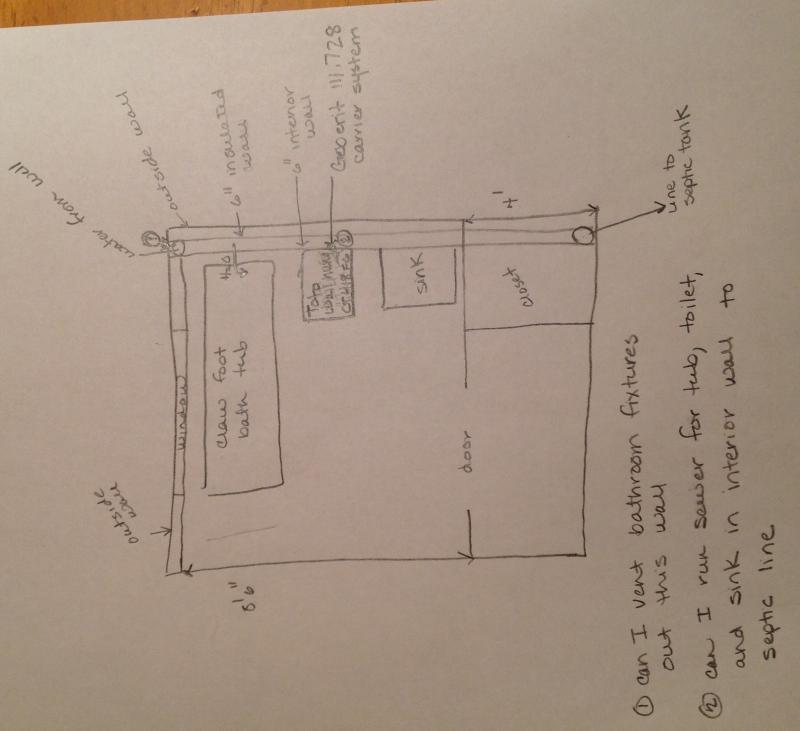

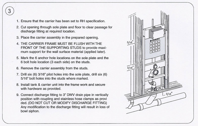

    I'm rebuilding an outbuilding to a Colorado mountain cabin. I want to make it into a bedroom with a bathroom. The structure is on concrete piers and there's no crawl space. I'll hire a plumber but I'm wondering if my design will work. The bathroom is on an outside wall. I'm going to build two 2x6 walls, one insulated and the other for plumbing. I want to put in a clawfoot bathtub, toilet, and sink. If I use a TOTO wall hung CT418FG with a Geberit 111.728 carrier sytem can I run the septic in the interior wall with the water? Can I vent the toilet out the end wall? Please see sketch.

    Please be sure to vent properly !
    Then run drain pipe out back wall and let run down side of mountain

    The toilet will run to a septic system. My question is can I run the pipe from the toilet horizontally in the inside wall?
    12,435
    You will want to vent the tub, the toilet and the lav.
    The lav can wet vent the toilet.
    The tub vent can tie into the other vent(s) at 42" above the floor. If you run the vent out the side wall, you will then need to extend through the roof.
    Water and DWV is normally done in the same wall. Having a wall of insulation behind the plumbing is a good idea. To keep the trap for the tub above the floor, (that's what you are intending?) you will need to raise it. Otherwise the trap is installed below the floor, with just the slip joint nut extending above the floor.

    The tub sits on legs so it's 4 3/4" above the floor. Can I run the drain along the floor to the wall and then use an elbow to run it inside the wall?
    12,435
    I realize that the tub is on legs, but you also have a waste and overflow, and that connects to a p-trap.
    The p-trap below the tub waste is going to take up some space.
    And you will need the p-trap unless you don't mind smelling your septic tank odors.
    A vent for a tub p-trap is typically within 42"
    More then likely, the p-trap will have to be below the floor.

    So I could run it to the wall and put the trap in a chase, insulate the chase, and then run the pipe horizontally to the sewer connection?
    Jan 2008
    2,681
    The trap will be at the bottom of the waste and overflow assembly, so it will be below the floor. You could box it in below the floor with an insulated chase and run heat to the chase. From the trap the drain will have to go towards a wall so that the vent take-off can rise vertically up the wall to go out the roof.

    A "sealed direct vent" heater, since it does not use room air for combustion can be installed in bedrooms and bathrooms. Your tub trap will be partially depressed through the floor, but most of it will be above the floor because its outlet will have to be at the height of your drain line, and if you do some measuring, I think you will find that the tub is TOO low for an above the floor horizontal drain line. The tub may be 4 3/4" above the floor, but drain "shoe" will be about 3 3/4", subtract from that the "end to center" of the drain tee, and you will be just about at the floor level, meaning, that if you can somehow get it connected to your horizontal drain line, it will usually stand full of water and thus have poor drainage.
