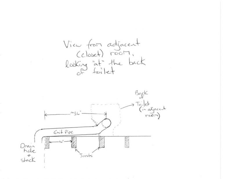

    First post, all. A great resource you have here.
    We're in the planning stages of converting a room in the top floor of a 100-year-old house to a bathroom. As seen in the attached picture, what used to be a brick chimney several decades ago is now a large hole running straight down to the basement, and ending almost directly on top of the existing drain pipe in the basement. Our thought was that all plumbing (and even electrical if needed) could be brought up from the basement directly to this bathroom.
    The problem is that the room is a long rectangle, the "hole" is in one corner, and the joists run across the room. We cannot drop the ceiling below, as it is decorative plaster, and we cannot shave or cut the joists (7.5" x 2.5"). So at least one of the toilet/bathtub/shower will have to be raised, as we cannot place exit pipes in the subfloor (except for along the wall on which the drain hole is placed, in between those last two joists).
    The room was a larger room that we're cutting in two; so that wall is framed-out only, and we can drain any plumbing through the back of the wall, on the adjacent side (which will only be a closet). Was wondering about putting a rear-outlet toilet (wall-hung or standing, doesn't matter) near, but not on top of, the drain hole; about 36 inches from centre of the toilet, to the hole. The exit drain for the toilet will have to drain out the back, then down and across ~36 inches before diving below the level of the finished floor and into the stack. The hope is that the toilet would then not have to be raised.
    1. Can this configuration be done without raising the toilet on a platform?
    2. What toilet would work for this configuration? I've looked at the Toto Acquia wall-hung, but the drawings show the elbow joint running straight down into the drainpipe in the subfloor. Is there a reason I could not have it draining off on an angle before it goes below finished-floor level?

    Am I understanding you that they're laid flat 7-1/4" wide by 2-1/2" high? If that's the case, you cannot even get the pipe in the floor. You'll have to raise the floor.
    If I'm misunderstanding, then how many joists do you have to go through? If only one, maybe two, you could maybe header off the joist and sister up some adjacent ones to make access. What kind of span are you looking at here?
    I know very little about wall mount toilets, but it could be an option. I think you need quite a bit of room in the wall, though, for the hanger and drain assembly.

    No, the joists measure 2.5 inches wide by 7.75 inches "deep" (again, 100+ years old) - so I should not cut through them to run any sort of pipe. The joists are spaced 16 inches apart.
    Yes, the idea is that the exit pipe would have to sit on top of the joists (of course at an angle) until it reaches the drain hole. So with a regular toilet, the floor would need to be raised. That's why I'm looking at rear-outlet and/or wall-mounted toilets, where the exit pipe isn't attached at subfloor level.

    Yes, I've looked at the carrier. The bonus with the wall-hung models is that the wall is only studs and the carrier can easily be framed in, and the toilet itself saves a lot of space by not "projecting" so much into the room (as there is no tank). The bathroom is not overly wide (6'10"), so it would be nice to shave 6 or 7 inches off the depth of the toilet. I've looked at models such as Toto Aquia and some of the Duravit wall-hung models, as well as their rear-outlet floor-standing toilets (there is one called Happy D.).
    I guess my question is, for a wall-hung toilet, is there any reason why the exit drain in the back of the toilet cannot run through the wall, and then sideways for 36 inches before dropping below the floor level?

    Ok. That makes more sense. Convention is to list the width first, and the height second (2.5x7.75), unlike your original post.
    If I were you, I'd really hate to bump the floor up the required 3.5" or so. So, maybe the floor mount rear discharge would work for you. Do you have some info on that, Jimbo?
    You'll need to furr out the wall to run the piping within the studs. If it's load bearing, perhaps more than if it's not.

    The wall is not load bearing (currently it's one large room that we're dividing with this wall).
    Do you see any problems with the pipe running through the wall, and along the back of the studs? As it is a closet on the other side of the wall, it would be easy to box it in from that side.

    I see no issue with it. What are you planning for a floor?

    Rough sketch of view from back:
    Name:  Toilet - drain (back).jpg
    When looking at a toilet like this Duravit Starck 2 for example - it sits on the floor, has no tank (I assume there's an in-wall tank system?) and the outlet is horizontal. Without being able to see the toilet itself, I've seen some of these that still have to have an elbow fitted that dives directly into the subfloor. Would it be possible to have it go right out the back and across?
    That is actually the perfect form that I'm looking for - shallow toilet, in-wall tank, rear outlet. Urk.

    Be aware that a tankless toilet ( i.e. Sloan Flushometer Valve) REQUIRES a 1" water supply line all the way to the toilet. This would be a major project.. There are options like tank hidden in the wall. As with most plumbing problems, ANYTHING can be accomplished using the proper amount of cubic dollars. ( a cubic dollar is the number of carefully stacked one dollar bills in a one cubic foot box, and is equal to about $10,000)

    I would expect the 3/4" incoming to be a deal killer. Essentially it uses the water supply system as the tank.
    Your sketch there will also need a vent too.

    You need a toilet with a tank (in-wall works fine, but you'll often need a thicker wall than from a tyical 2x4 studwall), or a storage tank with at least a 1" outlet (sort of like a small well bladder tank) to have the required volume of water available instantly. You should be able to plumb it horizontally as long as you can maintain at least the minimum pitch (verify with the manufacturer). Wall-hung gives you the advantage of easier cleaning underneath, but some do not like the look - depends on the style you're trying to achieve.
